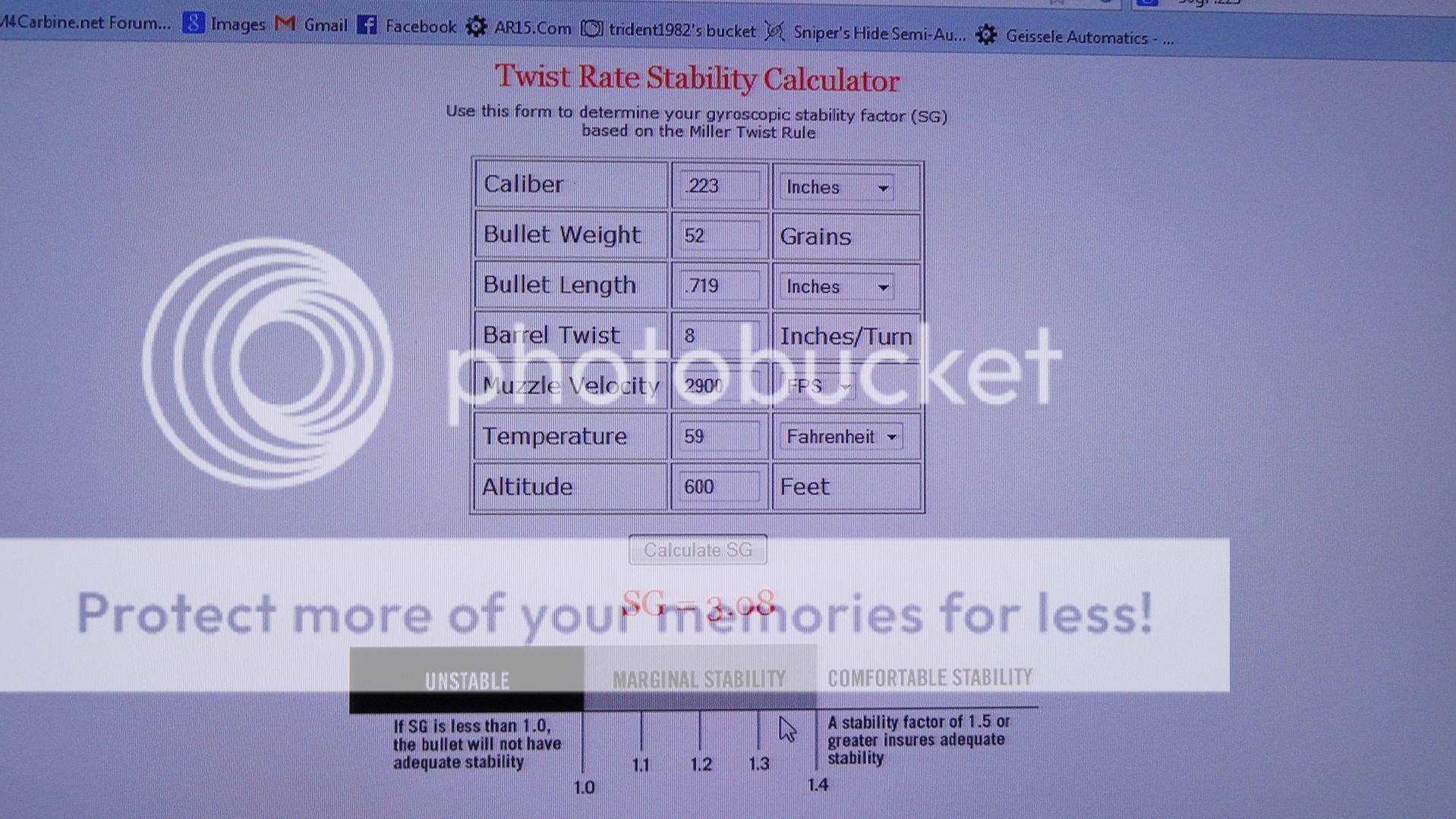

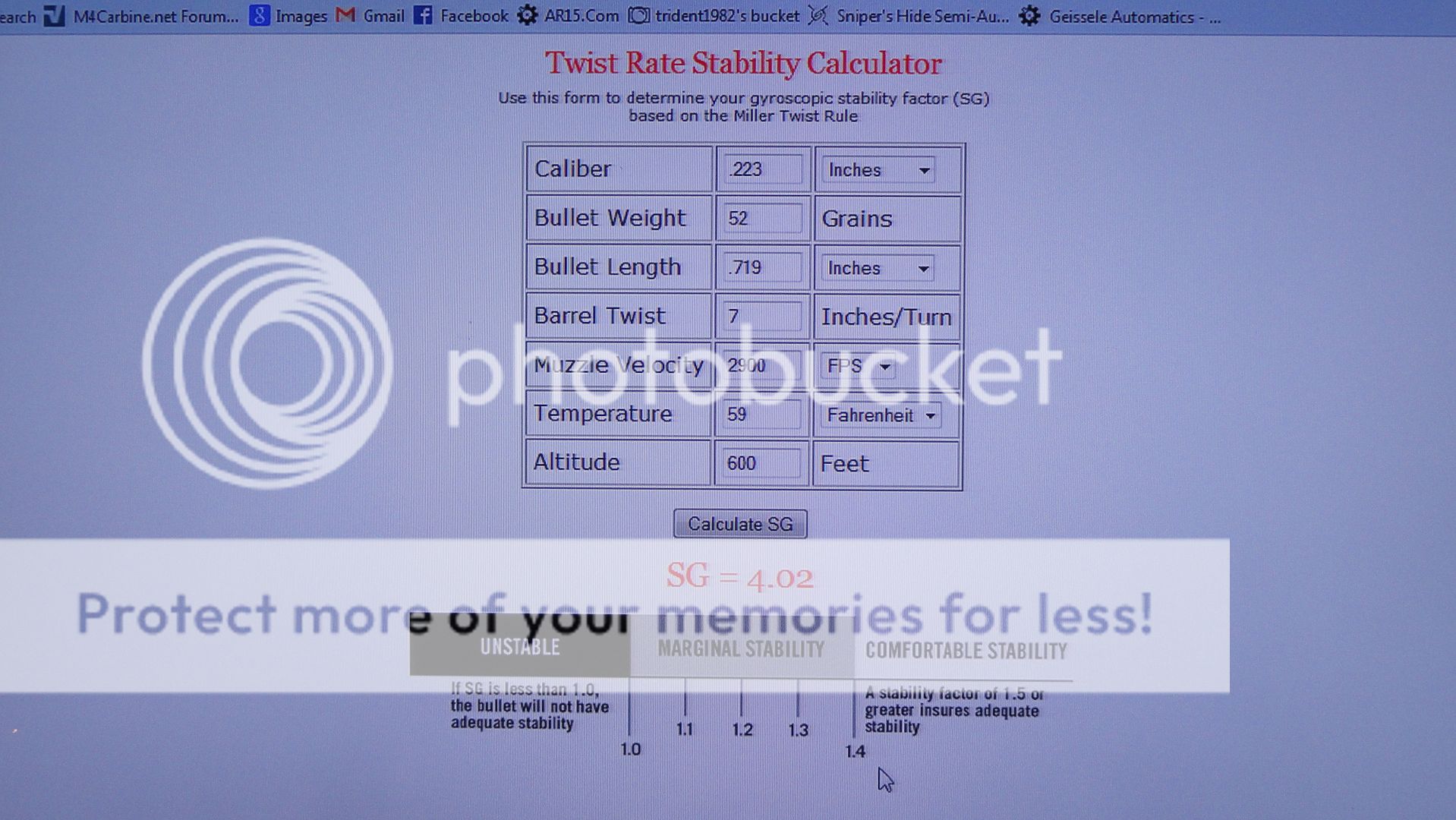

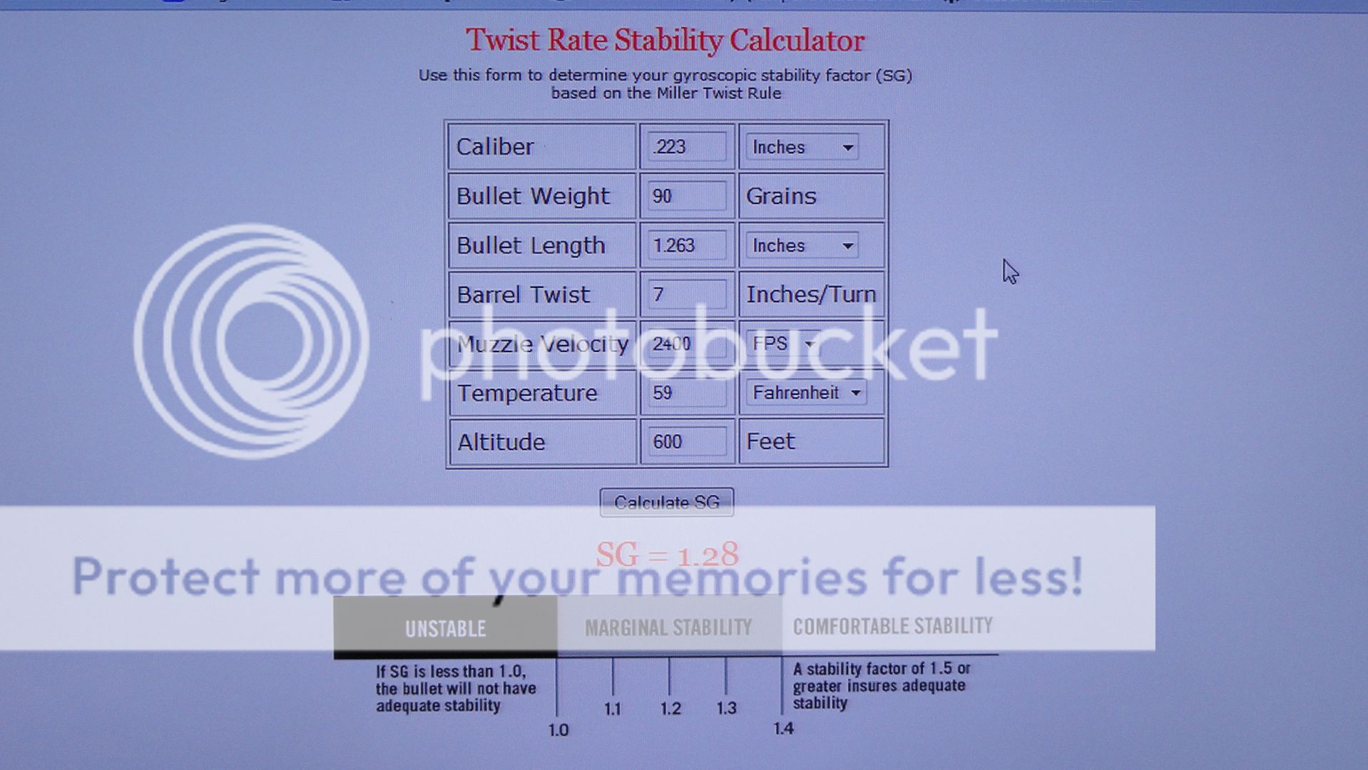

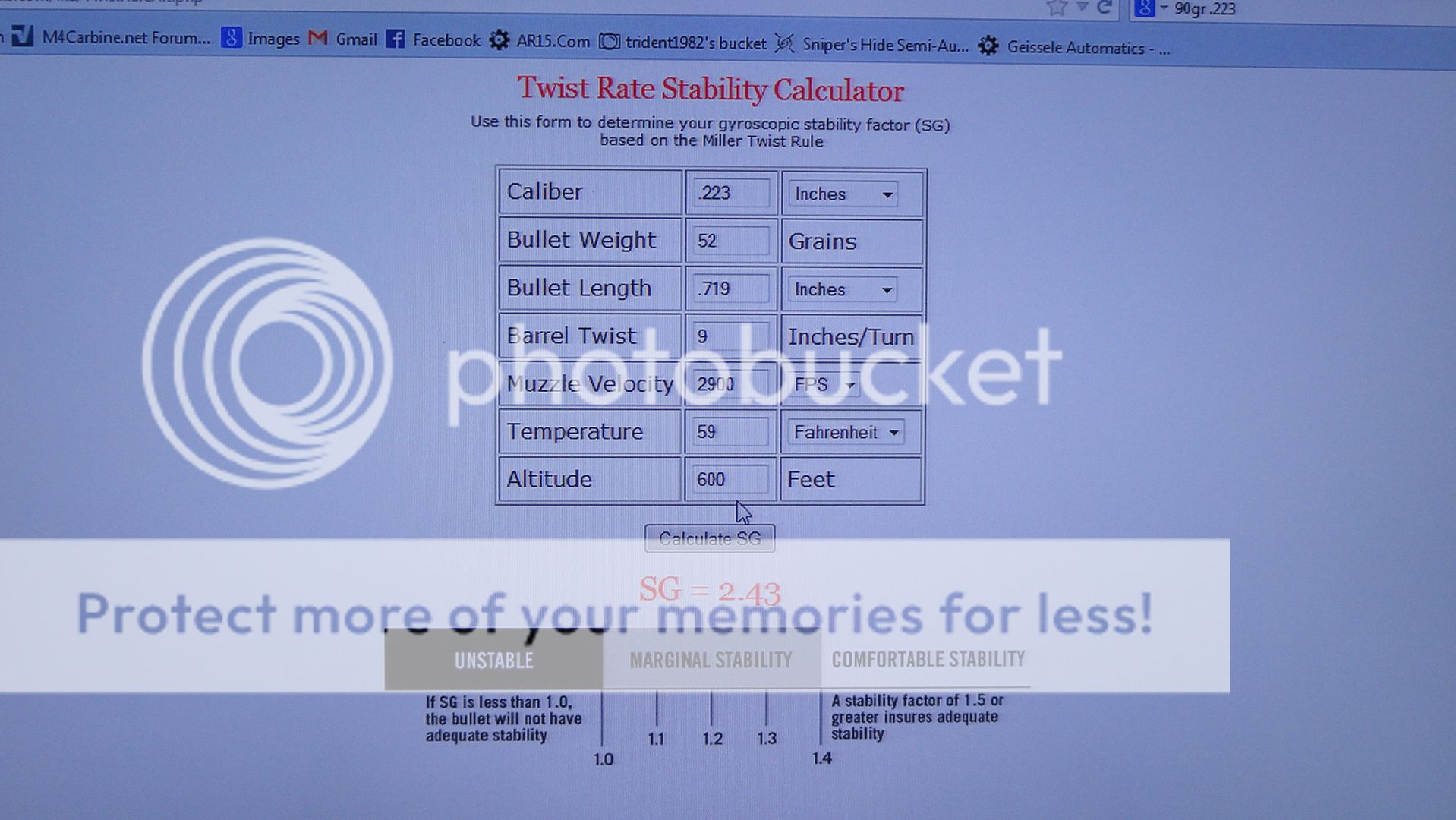

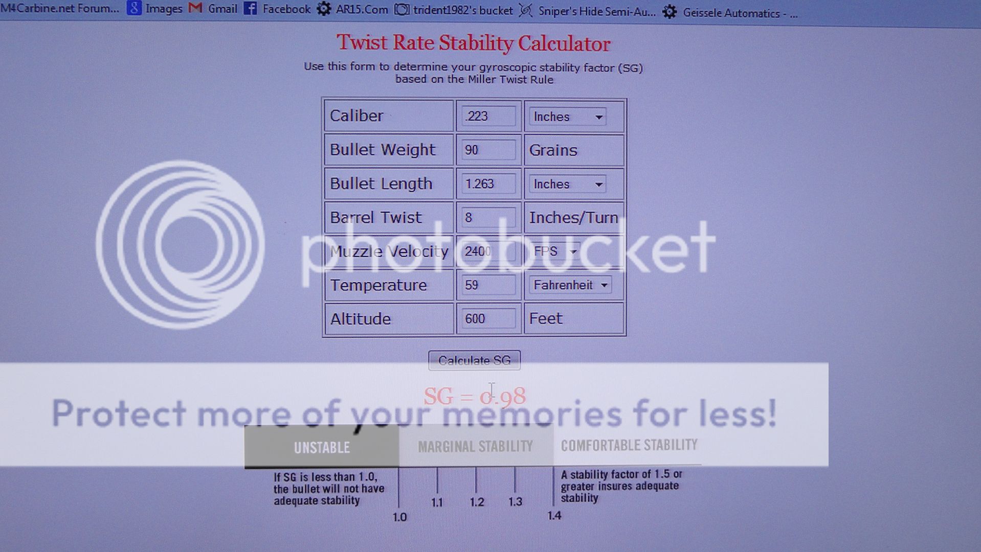

    5,117
    Let's look at the extremes of .223 projectile sizes/weights, and their formulated preferred twist rate by comparing their gyroscopic stability factor (SG) .....
    First set of charts are based on one of the heaviest projectiles made for .223, the 90gr. Berger VLD.
    90gr. VLD
    Chart 1: calculated w/ 1/7
    Chart 2: calculated w/ 1/8
    Chart 3: calculated w/ 1/9
    Now for the total opposite end of the spectrum...
    52 gr. match FB
    chart 1: calculated w/ 1/7
    chart 2: calculated w/ 1/8
    chart 3: calculated w/ 1/9
    Ballistician wizard Bryan Litz recommends in his book Applied Ballistics For Long-Range Shooting that you aim for at least a 1.4 SG rating when selecting a barrel twist for a particular bullet. This gives you a safety margin for shooting under various conditions, such as higher or lower altitudes or temperatures. Try changing the altitude and Temperature in the calculator and you will see that the SG drastically changes. Under optimal circumstances you should aim for a 1.4, that way if you change circumstances you are still over 1.1.
