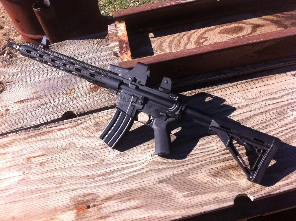

    I will detail my AR's setup:
    Dpms upper, lower, and barrel (barrel has probably 5000+ rounds)
    Spikes Tactical BCG
    Commercial buffer tube with magpul CRT stock
    JP Enterprises captured buffer/spring assembly
    Midwest Industries 15" Gen2 SS hand guard
    Smith Vortex FHMB
    Troy micro gas block
    Geissele SSA trigger group
    Daniel Defense front and rear fixed iron sights
    I know I gave more details than are necessary but if anyone has any idea why I'm having this key holing issue, any help would be greatly appreciated
