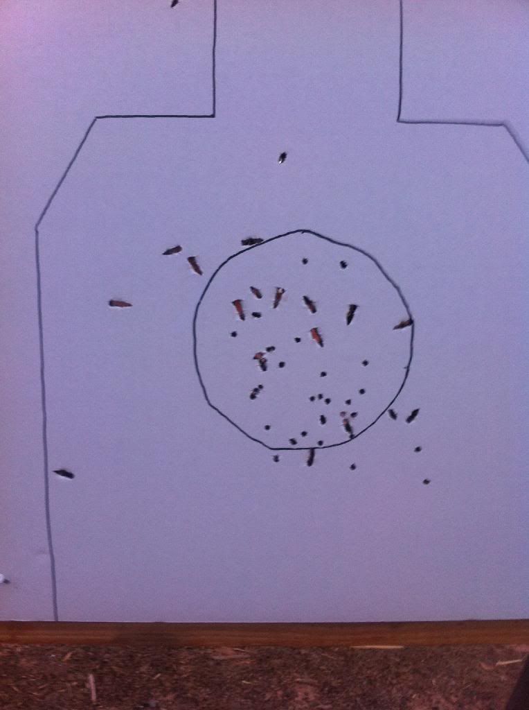

    Regardless of how clean you think your muzzle and crown is I highly recommend pulling the flash hider or muzzle brake. Cleaning the crown and shooting the gun w/o anything attached to the muzzle and let me know your results. Usually the gun will shoot like a shotgun w/buckshot and a cylinder choke at 25yds far before it'll keyhole.
    Attached is a "group" from a couple weeks ago with no muzzle device attached. The muzzle was thoroughly cleaned and inspected as well as I could.

    How much were the groups opening up before it started key holing? That looks like an 8 inch target, and I know this probably isn't deliberate aimed fire, but that makes this spread is about 24 MOA... If it's doing it with no FH, barrel is simply done. 5K rounds seems fast, but a non chrome lined barrel is definitely going to wear faster than expected, especially with accelerated firing.

    Something isn't right here.... only 5k through it and out of the blue it's keyholing when it hadn't before???
    Is it possible it had been doing this much longer but wasn't shot on paper?
    All shooting has been done of paper, cardboard, some sort of target.
    The groups weren't really opening up that I saw. That target was shot off hand from about 25yds with DD fixed iron sights (love em) and it was not deliberately aimed. Shot off bags with the iron sights I can still get 5rds in about a 1.5" group at 50yds. Granted I'm not sharp shooter but I think that's a respectable group for factory ammo.

    I was goin through the pics of targets that I have and found this one.
    This is from around the time I started to see the key holing begin. As you can see there are a number of holes showing proper bullet impact and then a bunch of profile impacts.
    I believe this was 2 magazines worth sent down range and I began to assume that the normal impacts were from the cold barrel and then as the barrel began to heat up then the tumbling began.
    Any thoughts on this? And again I am really appreciating all of the input and knowledge that y'all are offering up!

    I have a 7.5" 5.56 barrel used on an M16 lower as a 'blast O tron' that I've replaced. It likely had 5k to 10k through it (as well as 22LR). It started key holing like yours. The rifling is almost non-existent. The gas port is also flame cut on the inner bore significantly.
    Either your barrel is somehow copper fouled reducing the effect of existing rifling or the rifling is worn down.
    Don't use a suppressor on this either...
    I'm guessing the barrel is toast. Sorry.

    Quote Originally Posted by funkybassplayer View Post
    You should have someone spot for you and watch exactly when the bullets are going wonky. In any case, I'd dump this barrel quick.

    Key-holing bullets without a muzzle device of any kind indicates bullets are too heavy or simply that the barrel's toast.
    Low-grade mass-produced barrels coupled with abuse can ruin a barrel in less than 2,000 rounds. I've seen some custom barrels from mass blanks do screaming tight groups for about 1200 rounds before any kind of precision goes completely out the window.
