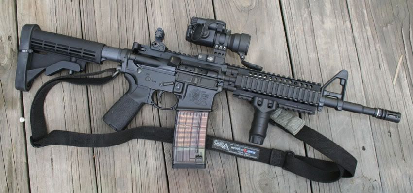

    This is an old pic when my 10" LMT had a FSB and a KAC RASII rail.
    Then I 'shaved' the FSB and installed a 9" DD Lite Rail.
    Nowadays it's looks like this.

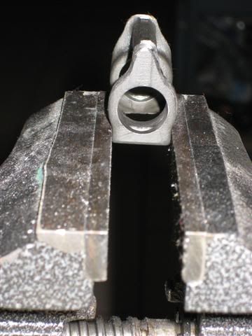

    I'm with Robb, I greatly prefer shaving down the FSB. I've paid to have it done once and I've done it myself once. Wasn't too difficult at all. When I was done I just sprayed it with hi-temp grill paint and it's still chugging along just fine. If it was going to be exposed to bumps and scratches I might have opted for a tougher finish, but since it's protected by the rail I'm not concerned.
    If you don't feel comfortable doing it yourself, ADCO will do it for you. When they did mine I bought the DD 9.0 rail from them and they didn't charge me to install the rail, just for the price of the rail and the price to shave the FSB. Don't know if that's still their deal or not.
    Here's some pics of my shave job (some in-progress and some complete)
    and the final products

    Here's my 12.5" SBR that started with a 7" Lite Rail, then I shaved the FSB and added a 9.5" Daniel Defense RISII MK18 rail.
    Before:
    After:
    Then it's latest pic, just yesterday:

    In case Robb and I weren't clear, I wouldn't (and I don't think he would either) advocate doing this work with the FSB still on the barrel. You can see from my pics that it's removed and clamped in a vice.

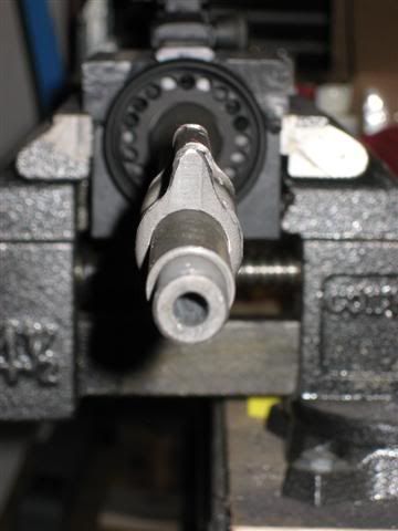

    Correct. I'd only do it on the barrel if you had a non removable muzzle device. Since your adding a DD Lite Rail you'll have to take it off anyway since the DD has it's own proprietary barrel nut.

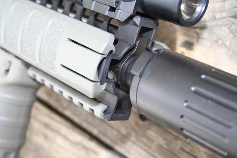

    The more I see gotm4's rail/light setup, the more I like it. I photoshopped this using LaRue's weapon profiler to get an idea of how the 9" rails look with a 16" barrel. It doesn't look as bad as I thought it might...
    It works very well. I used my 10" SBR set up this way for the mods/staff Vickers class and it worked very well for the low-light night stuff we did.

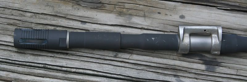

    Here's some pics of a shaved gas block and barrel, the gas block has been sandblasted after shaving and refinished with flat black Norrells moly before reassembly.
    Here's one I recently did while it was still attached to the barrel since I was installing a 10" Troy rail (which clamps onto the stock/OEM barrel nut) and the muzzle device was perm. mounted.
    After shaving and sandblasting:
    after refinish w/Norrells:
