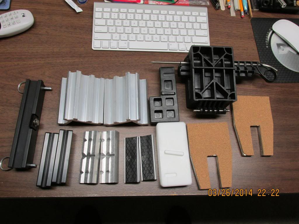

    Quote Originally Posted by Kokopelli View Post
    This set does everything I need to do, vise wise.. A few common tools and specialty tools and you're GTG..
    It looks like the only other thing you need is another safe

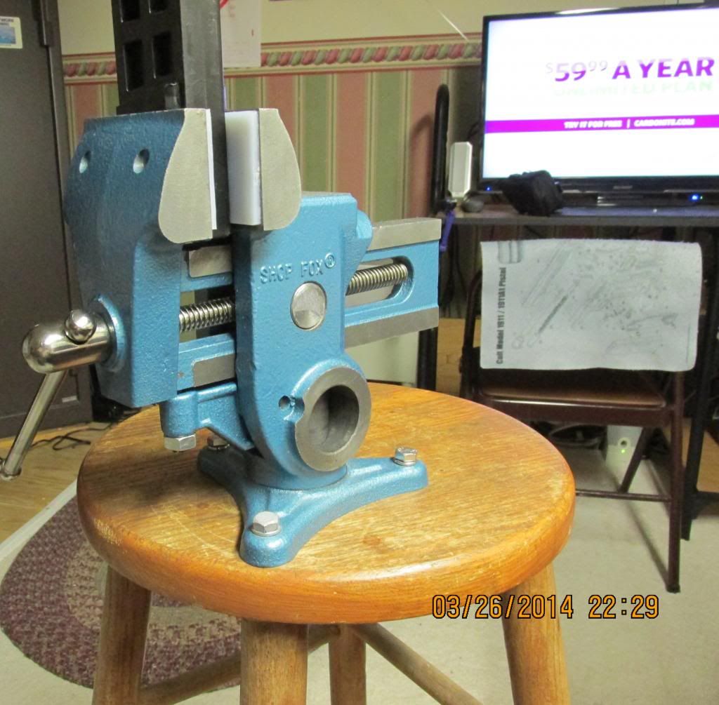

    On second thought, you may want to get a heavier vise for torquing the barrel not. I just snapped the head "Shop Fox" installing a barrel. I've installed several use yhe vise without problems, but this time was "no bueno".. I ordered a replacement as it's just too useful to be without one, but I'll pickup a heavier one for barrel nut jobs..
    Ain't no pockets on a shroud..
