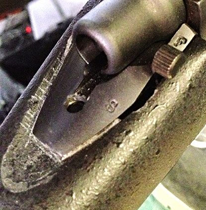

    Here's the bedded stock.
    Everything looks good in the recoil lug area.
    And the Devcon is nice and even down the length of the action.

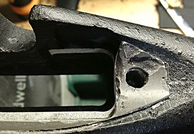

    But there's a spot at the rear mount that was not even.
    I really thought I had more than enough epoxy and got good roll out everywhere but there is a definite hollow spot there. It looks like there is enough for good support and the edge looks even when the action is installed so I think I'll leave well enough alone until I can get it to the range.
    I'm afraid that if I try to fill that void I'll end up creating a high point and causing stress when the action is torqued in.
    Any thoughts?

    See how it groups before you do any thing else.

    For sure first test it out.

    Looks good, don't worry too much about the rear tang yet. Make sure when you torque the action screws you actually use a torque wrench and run them in evenly alternating sides.

    Yep, torqued to 60inch pounds, evenly.
