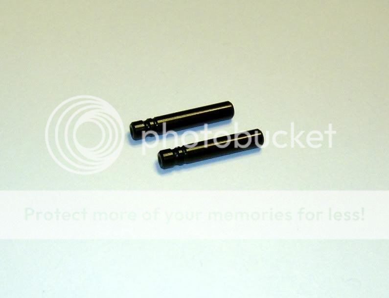

    Quote Originally Posted by BTL BRN View Post
    Agreed, though in fairness I believe I read that KNS is making pins (upcoming) that will be properly hardened for use with G triggers.
    I don't believe it has anything to do with pin hardening. KNS already hardened their pins some time ago.
    It is because the KNS pins are slightly smaller than the G pins. The biggest conflict comes when using the KNS pins with the High Speed Trigger due to the C-Clamp.

    Quote Originally Posted by HuttoAg96 View Post
    It's just a .22, but I've got an M&P15-22 (polymer lower) that occasionally stops functioning when one of the hammer/trigger pins walks out and the FCG gets bound up. KNS pins are a cheap, easy fix for that issue. I wouldn't expect that kind of thing to happen on an in-spec metal lower. To me it is a possible solution when there is a known problem, but not something I'd do preemptively.
    That's similar to my thoughts regarding these pins. They are not necessary unless you have a specific need for them or your lower starts having issues.
    If they were truly necessary, you'd see all the Military M4's/M16's with them from the factory. I've never seen one that does...
