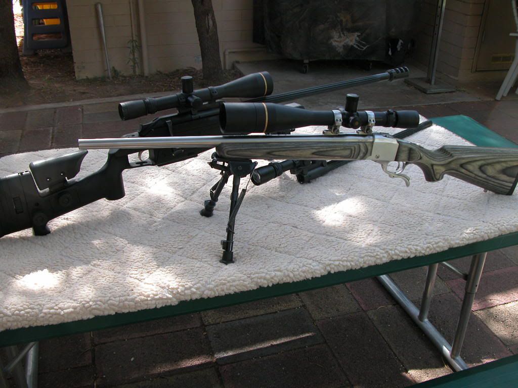

    I thought I would try to post a picture of the LRS2 as I mentioned. You can go on the Blaserpro forum to see or get more info about this gun and all the calibers available with them including the .308 if that is the caliber you want.
    BTW, I am not trying to sell something this is just another idea for getting extremely accurate rifles to begin with just as we assume with the Rem 700s.
    The R93 action in the Blaser is easily matched to the frame and can be had in standard rifle configuration or something like the LRS2 as shown.
    And certainly one might consider perhaps the least expensive application of all by re-barreling the Ruger#1 which is an excellent platform.
    Here are both and again the R#1 is in 22-250 also.
    As I said, just another possible pathway to your goal.
