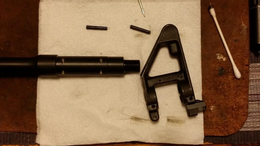

    Got the barrel today. It looks pretty good. A few initial observations are:
    1. The port is about .078"... Too rich for me, but I hope a heavy buffer can rein it in.
    2. The port is obviously reamed post QPQ, but Aero already posted that fact, and
    3. The taper pins are reamed a little deep into the barrel. In the pic, you can see that the pin holes are so deep into the meat of the barrel that they are enclosed. Not necessarily the end of the world, but not quite the ideal 50% of the pin diameter that would be ideal. On a 10.5 blaster, this shouldn't be a big deal. The pins come partially driven so that you can easily remove them to install your barrel nut.

    thats interesting Mark. Thanks for sharing.
    I'm surprised they are so deep, but for the price and the gas port size (.007" isn't far off) I might grab one of the FSB models
