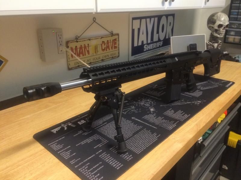

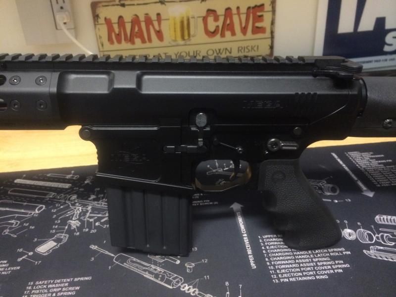

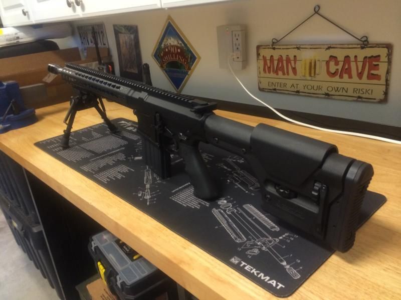

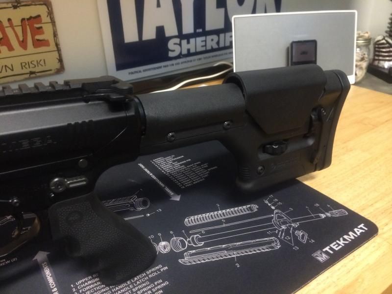

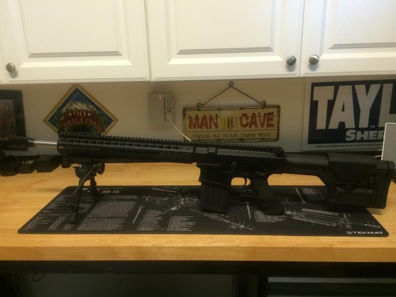

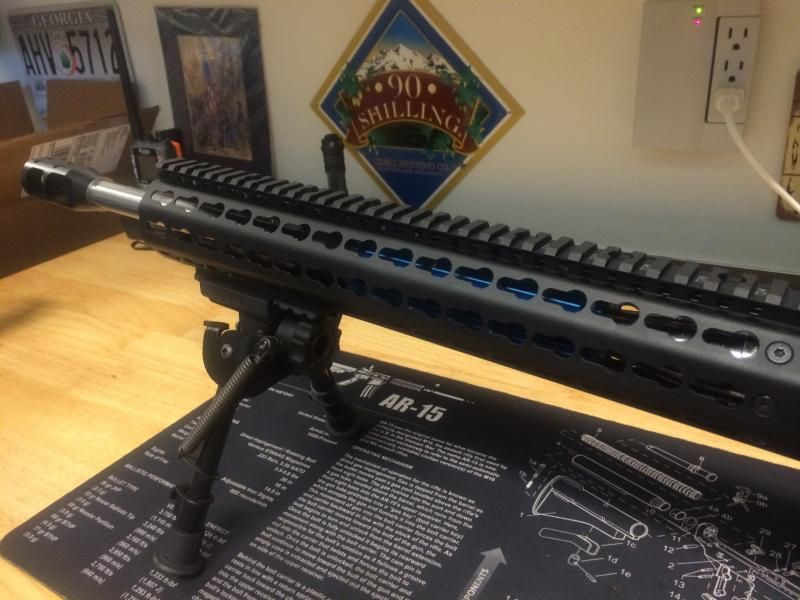

    I finally rounded up all the parts that I needed to complete this build. I already have more than a few 5.56 rifles so I wanted to build a 7.62 rifle. I was thinking of getting a Larue as I have shot them a good number of times but did not want to wait a year or so and besides building your own is more fun. I did not know it at first but I found out that I was able to use all 5.56 parts on the lower except for the take down pins and bolt catch which is a real nice feature(which came installed anyway). I took it to the range just to do a functions check on it and had no issues. I stripped and re-painted the scope with Dura Coat so once it cures up I will post on how she groups.

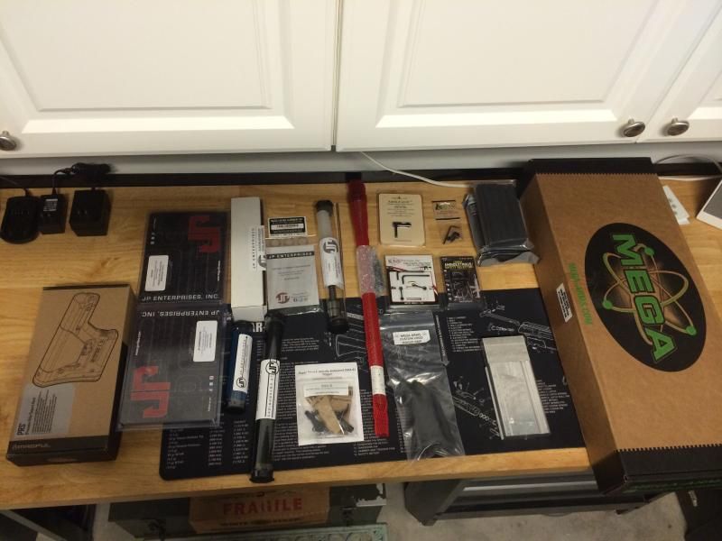

    Components:
    18" JP Supermatch Barrel & Enhanced Bolt
    JP Thermal Dissipator
    JP Low Mass Bolt Carrier
    JP Steel Rifle Length Buffer Tube
    JP Bolt Carrier Pins Package
    JP Low Profile, Lockable, Adjustable Gas Block
    Mid Length Gas Tube
    JP Silent Captured Spring
    JP Tactical Compensator Black
    Magpul PRS Precision Stock
    Norgon Ambi-Catch
    ODIN XMR Extended Mag Release
    Geissele Enhanced Combat Trigger - SSA-E
    KNS Anti-Rotational Pins
    Selector Switch: BAD-CASS-SA - Standard/Thin 2 Levers
    MEGA Pistol Grip
    MEGA Extended Rifle Length Keymod Matched Upper and Lower
    Larue Bipod and Scope Mount
    Leupold Mark 4 Fixed 10 x 40mm LR/T M3 M-24

    Nice!
    Can't wait to hear how she shoots! I have been wanting to finish a very similar build for a long time now.

    Sweet ! Good looking rifle !

    I went to the range yesterday to tune the gas block (waiting on a different set of scope rings to zero then I will post how she groups). I turned the set screw all the way in and back 2 turns, shot and bolt still cycles. I turned the set screw all the way in and she still cycles. I was under the impression that with the set screw all the way in I would be closing all the gas off. Is this correct? She shoots real soft but makes me wonder if I got a bad gas block. Unless I am turning the set screw the wrong way but I am fairly certain that is not the case.

    I am not too concerned since it does shoot soft, just wondering if anybody had experience with them. The Larue mount is nice but how the mount is set back I can not move it any further to the rear to get the eye relief that I want. I am going to use it on the SPR that I built awhile back. I ordered a set of Badger Ord. rings that do not have the QD link. UPS delivered them today so I am going to head to the range sometime this week to zero.
