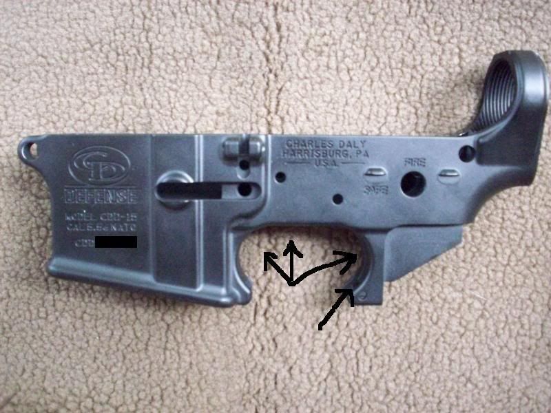

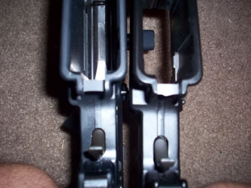

    I do have another issue but it is primarily cosmetic. The pistol grip is canted to the left. I'm not sure if the grip is off or the lower. The lower does have some sloppy machining around the trigger area as indicated in this picture:
    Bushmaster on left, CD on right.
    There is a ridge that runs along the center and it is uneven in height and where you mount the trigger guard with the roll pin, if you look down between the ears, it is very noticeable and quite jagged looking. I will get pictures of it late when I have my camera available. This does not interfere with the function, however. My Bushmaster lower also has a slight ridge but it is much less noticeable and and uniform. I am chalking this up to being a preproduction lower. For the price I paid, it is fine since it functions fine. If this was a production unit and I paid full price, I wouldn't be as happy.

    I do have another issue but it is primarily cosmetic..... The lower does have some sloppy machining around the trigger area as indicated in this picture:
    There is a ridge that runs along the center and it is uneven in height and where you mount the trigger guard with the roll pin, if you look down between the ears, it is very noticeable and quite jagged looking. I will get pictures of it late when I have my camera available. This does not interfere with the function, however. My Bushmaster lower also has a slight ridge but it is much less noticeable and and uniform. I am chalking this up to being a preproduction lower. For the price I paid, it is fine since it functions fine. If this was a production unit and I paid full price, I wouldn't be as happy....
    The forging "flash" in the trigger guard area is quite typical of most AR's. A few companies machine it away completely but most don't. We compared ours to several other brands, including Colt, BM and RR, and found that it was no better/no worse than them.
    I would appreciate comments from other members on this "flash" subject. Do you find it objectionable? Do you think it should be machined away completely knowing that doing so would increase the cost?

    I got both of my Preproduction lower's in yesterday and noticed the same thing as you with the machining in the trigger well. I got out several other maker's lowers I have(colt,rra,s&w,dpms,stag,cmmg) and noticed the same thing on all the others, the CD is a little more noticable but for the Price and fast service I am not going to bitch. Just need a good upper to mate them to.(maybe a CD 5.45x39?)

    Since you asked,..why not go above and beyond and spend the extra $1.50 and go the extra thirty seconds to machine the excess flash away so that everything is nice and flush? Things like this obviously don't go unnoticed. Why not stake your name in the AR arena on a high quality product instead of "industry average"? If it were my company, I would insist on it.

    Quote Originally Posted by Charles Daly View Post
    ...I would appreciate comments from other members on this "flash" subject. Do you find it objectionable? Do you think it should be machined away completely knowing that doing so would increase the cost?
    until this post I've never even thought to look at that area of my AR's. Of course I had take a peek at what's in the safe:
    - Colt 6920 (purchased in early 2007) had as much unfinished flash at the CD pictured above
    - Noveske N4 lower build (purchased several months ago) was finish machined w/no flashing evident
    I don't find it objectionable at all (didn't even realize it was there until today). I've never felt it during use, it's not noticeable unless I'm specifically looking for it - I say leave it be...
    I say leave it as is...

    Quote Originally Posted by Creature View Post
    I did ask and I will consider all responses. If it was only $1.50 and 30 seconds it would be an easy call. But it's not, it's more than that. The additional cost doesn't mean all that much in a finished rifle but it means a lot if we are just selling a stripped or complete lower. This is an extremely competitive market (lowers) and for a $10 bill, people will buy another brand.
    And we are staking our name on a high quality product. It's just in areas where it actually means something to the function, reliability and "overall" finish of the rifle. Anyone that has already handled and fired our AR's will attest to that. We go way beyond any "industry average" as you call it. Since the majority of members here will compare any and all comers to Colt, and since our "flash" is the same as Colt's, then I didn't see why we would lose points based on this subject.
    The forging "flash" actually means something to some people as it indicates to them that the lowers are actually forged and not cast.

    I got 2 blems and 2 pre-productions and I hadn't noticed anything untill I read this post! I am very satisfied with the whole purshase ,But like everyone else it made me get out my S&W 15T and compare.
    The S&W forging flash has been machined. It ''looks'' a little nicer, It was much more pricey. I am just fine with the Flash being there for the added value as i am a budget shopper anyway. Function and Value are more important in my view (in that order). With that said I my opinion is from that of a shooting Enthusiast and not from an Operator or professional, .02

    I'm curious to see this when I get my lower. I've never given it much thought either but I know I've seen lowers and thought "wow, that's rough".

    Forged lowers with correct dimensions are fine. I have seen more than a few USGI lowers like this.
