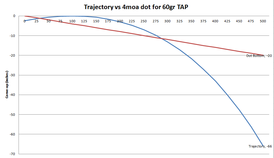

    Okay, thanks for the input, all. I'm definitely going to try some different targets next time out - both the B2, and an 8" dot and see what happens. Due to cost, and apparent acceptable accuracy, I'll most likely be using the AE blackbox 50gr varmint.
    I think the breathing may have been an issue, and maybe inconsistent cheek-weld. I noticed there may be minor parallax issues with the PA micro.
    As for POI/POA, I have it set up to hit the top of the dot at 100yds. I graphed theoretical 60gr TAP ballistics below, the red line is the bottom of the red dot, and the top is the x-axis. I do see some theoretical benefit as you can use the dot as a hold-over. For example, at about 275-300yds the bullet will impact within an inch of the bottom of the dot. That said, you could do the same with a 2moa dot as well.

    Quote Originally Posted by MegademiC View Post
    That chart is a fantastic visual aide. That really sheds some light on the dramatic change of bullet position within the dot relative to trajectory. Thanks for posting it. I recently shot mostly irons at a 12" x 20" steel silhouette at 300 meters, but briefly tried the dot with little success. Considering the dot is also 12" wide at that distance it is no wonder. I like your thinking here, and I'm going to give this a try.

    Quote Originally Posted by GunnutAF View Post
    That is not a "Fail"! What your seeing (Assuming center hold) is the difference of the loads used (Lot#, bullet wts) and the effect of barrel harmonics! If your saying the the fail is the group size then stop using a dot, use a scope instead ! A dot is not made to shoot bug holes.
    People do it with irons, I should be able to do it with a dot... Figuring out "how" is a little different though. I remember seeing molon posting a very impressive group with an rds... 3 shot composite int the 1.2" range. I don't have a scope yet, but want to find out what shoots well out of my gun... hence the range trip that led to this thread.

    5,184
    The chart fits what I have observed with my own setup. I have to hold the bottom of the 4 moa red dot on the top of the head of a B-27 silhouette at 400 yards to get center mass hits with 62g ammunition.

    Quote Originally Posted by T2C View Post
    Thanks for the feedback. I'm looking forward to trying it out, hopefully this weekend.
