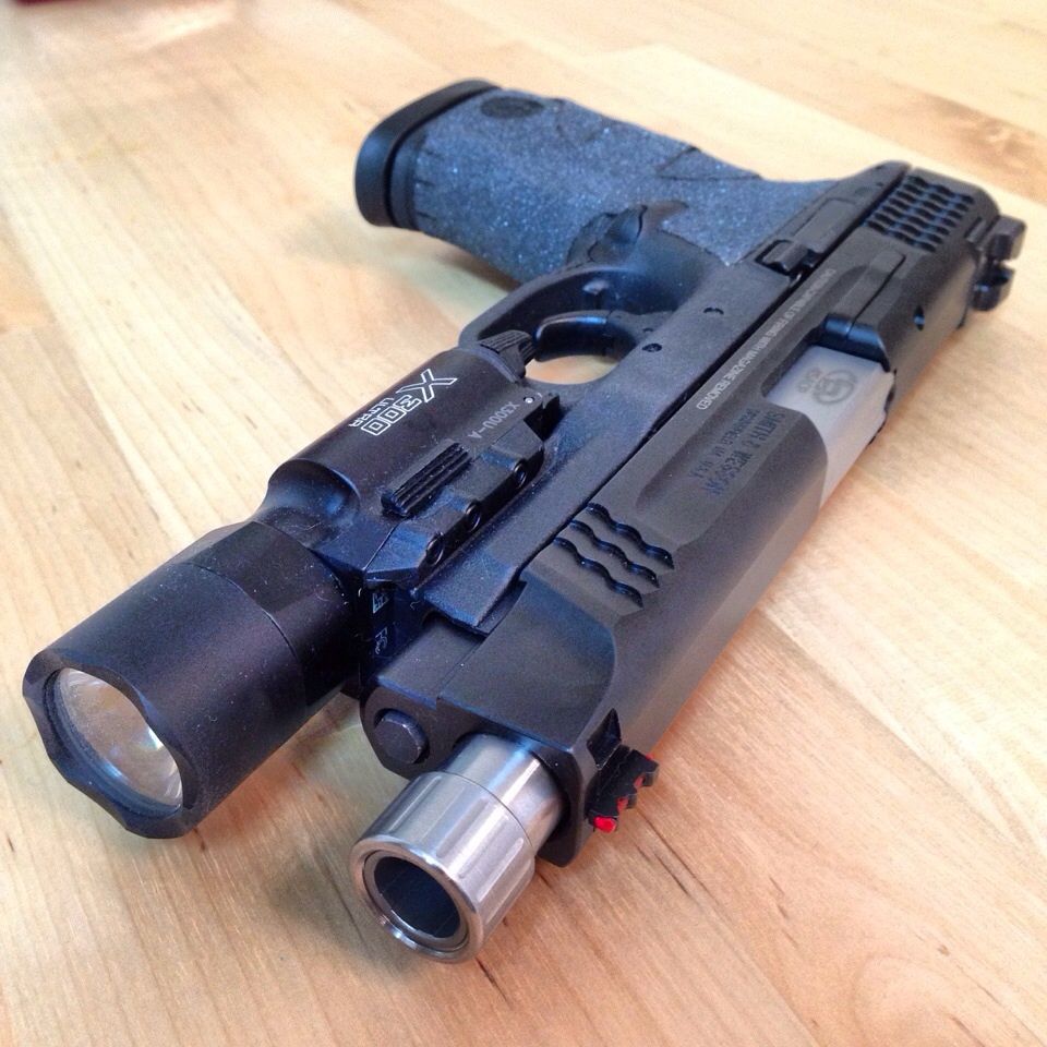

    Storm Lake match grade threaded barrel came in today, fit & finish is great. Doesn't look like any hand fitting or sending back will be needed. Nice tight tolerances and the round fits in the chamber no problem. On the box it says the threads were made to match AAC & Silencerco. I am happy so far, just patiently waiting for my Osprey now
