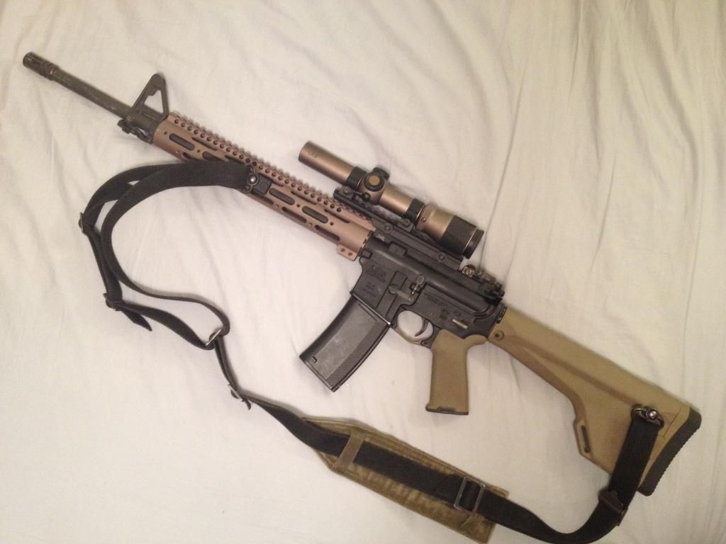

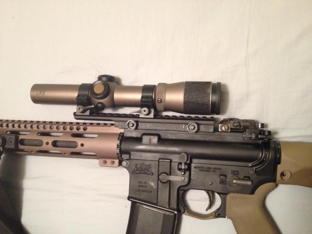

    Well, the Valdada riser arrived today. Long story short, it works... just not quite as well as I was hoping. When installed, the riser actually raises the rail surface 0.55"... a lot higher than I had hoped! The Leupold rings put the scope just a hair higher than the irons, but it's at least a good 0.1" lower than the Primary Arms mount it was in before. Cheek weld is noticeably better. The combo of the riser block and the solid steel Leupold QRW rigs is unfortunately a good bit heavier than the aluminum PA mount though. I may try some slightly lower rings, but with the height of that riser, I only have about 0.1" of clearance between the ocular housing and the riser, so I can't go too much lower with this setup. I will try to find a lower riser.
