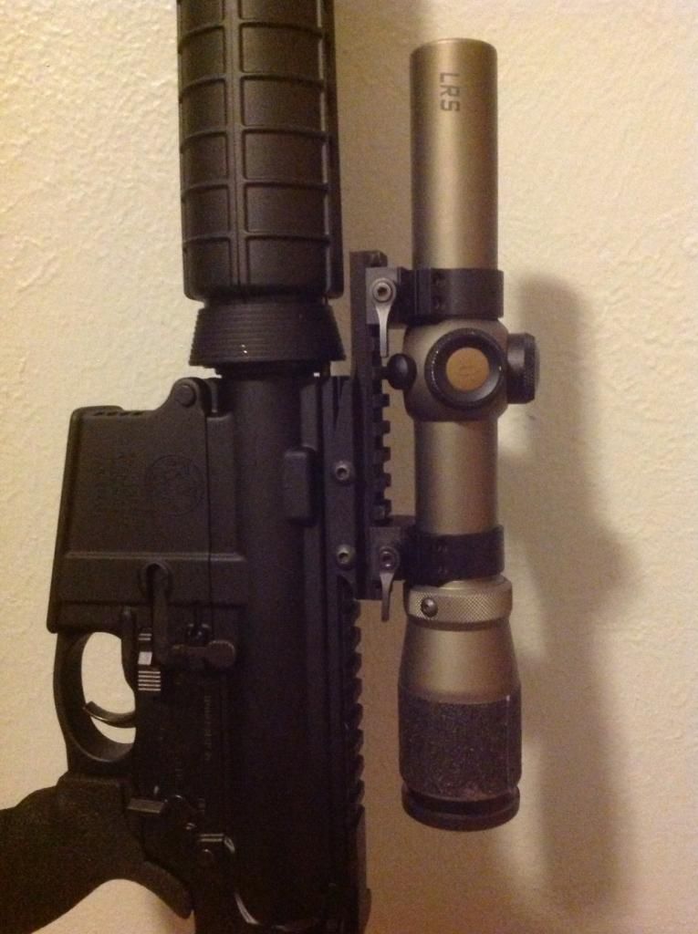

    I got the YHM riser today. It does pretty much what I was hoping it would. I am still using the Leupold 0.97" rings. As you can see, I can go to quite a bit lower rings without clearance issues, since the ocular housing hangs over the back of the mount, unlike with the Valdada riser. This is also significantly lighter than the Valdada. The combo of this riser and the rings, even being steel rings, is still lighter than a Burris PEPR. I have some aluminum Vortex low rings on the way, and if this works like I think it will, there will be no reason for me to spend more on a one piece mount. Also this way if I ever get clip-on NV, all I have to do is put a little higher rings on it. This pic is with it installed on my M&P 10 by the way.
