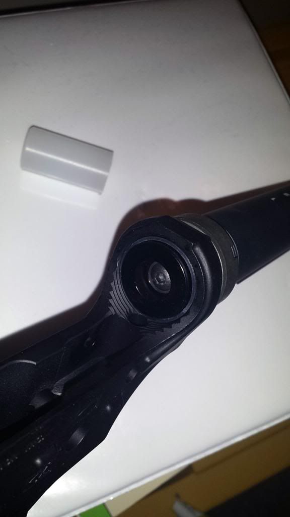

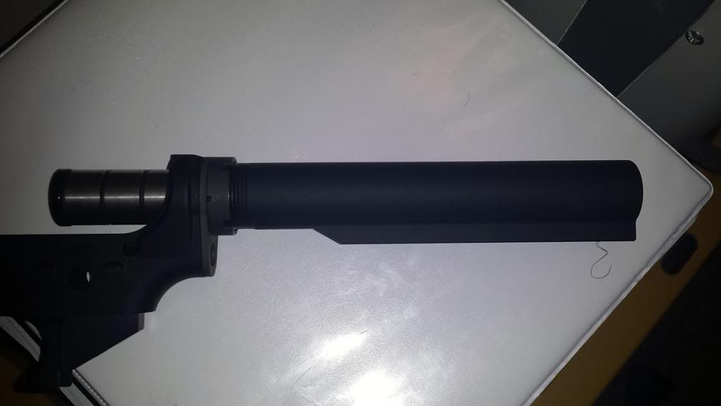

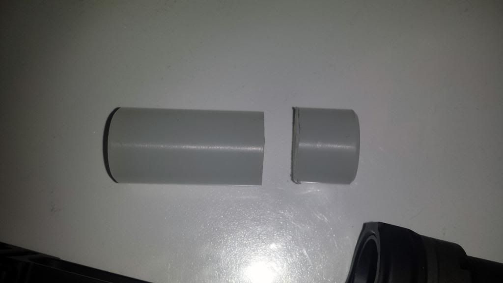

    I currently use the VLTOR A5 with JPSCS and like it. I'll take my other lower with the A5 and standard buffer to compare how they shoot next week.
    The spacer that JP provides needs to be cut down to fit the A5 extension.
