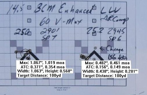

    Having had such awesome luck with an 11.5" BCM LW I decided to try their newest offering in "budget priced" barrels. I am more than pleased. The one flyer in the 24.8 gr group I could not account for... Still considering the 24.6 and 24.8 impact area is virtually the same, I'm loading some 24.7 grain loads for tomorrow morning.
    Ammunition was all virgin Winchester cases circa 1995 case weight 92.5 grains or less. Federal 205 match primers and AR Comp powder loaded to 2.254" COAL complete the specifications. An Oehler 35P placed 15 feet from the muzzle captured the velocities.
    Yes the lower is stamped... don't get excited. ACOG TAO1NSN 4X, Giessele HiSpeed match trigger.
    Attached Images Attached Images

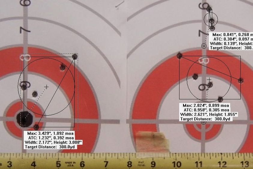

    300 yard attempt, two best loads to date, Nosler 55 BT's left, Hornady 60 V-Maxes right. Velocity and BC's are nearly identical so poi is about the same too, sweet.Sight adjustment after the first 3 top right (other two bumped off, Oops!) Getting the Giessele sear just right take some time.

    That looks great. You HAVE to try some 77s. I bet you can shave an inch off of the 300 yard group. You're at MOA at 300 which is pretty kick ass for the relatively light bullets at that distance. I have to think 77s will do even better.
