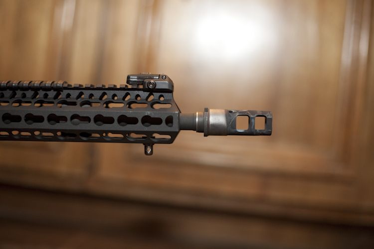

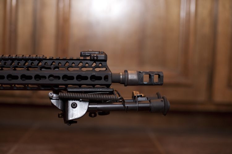

    Here are the pictures.

    I've got a 12" Seeking SP3R (the flat-bottomed one) with a flip-up gas block/sight. I first tried the Primary Weapons Keymod mount, but found it took up too much space and set the mount too far back for my taste.
    I've since gone to the super-minimalist Noveske mount. It's small and allows me to mount the bipod as far forward as possible. However, I'm finding that it has a propensity to unscrew itself ever so slightly where the bipod will twist and turn. This would be problematic if I was in a hard-use situation. For the target practice and occasional predator hunting, it'll do for now.

    I have an Odin Works K-Pod adapter that works well for me to attach a Harris bipod to my Keymod rails (KMR and NSR). I chose the K-Pod over the Noveske and IWC options for two reasons: I didn't want to spend time removing my rail to position the nut directly under the gas block, and I also felt that the K-Pod design was less prone to breakage as the design is more protected than the standard bipod stud.
    So far I like it, but had a couple of issues with it when trying to mount the K-Pod under a gas block: The mounting screws that the K-Pod is supplied with are too long to fit directly flush with the Keymod nuts when they are tightened down. I solved this by replacing them with a pair of 3/16" long screws (if I recall correctly. It could have been 1/8") that fit just under the gas block with just enough clearance between the gas block and the hardware to prevent them from touching. The supplied hardware is an issue that I would really like to see Odin Works fix in their upcoming production models.
    My second issue is more one of personal preference than one of importance: using the K-Pod to mount a Harris bipod offsets the bipod from direct contact with the rail surface by about 1/2". Those are my only two concerns and observations.
    I really like the fact that I can install the K-Pod on either one of my uppers in a matter of seconds, and that I haven't broken it so far (I break everything).
