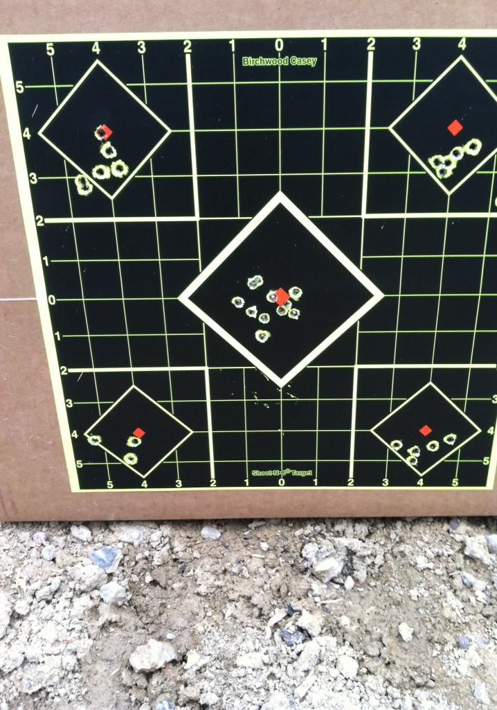

    The red bullseye on the 50-yard test target I used was 4 MOA. The green was 2, I think. I'd be happy with 4 at this point. That's my current goal.
    2 MOA is 2" circle at 100 yds. 2 MOA at 50 yds is a 1" circle. Think of MOA (minute of angle) as a pair of lines representing an angle exiting your barrel. The distance between the lines that start together at the muzzle gets progressively wider the further from the muzzle you measure it. 1 MOA is 1" at 100yds, 2" at 200, 3" at 300..... Example- If you shot a group with all bullets landing within a 1" circle at 50 yds it would be a 2 MOA group. If you shot another target at 200 yds and all of the bullets land within a 4" circle its still a 2 MOA group. If shooting at 25 yds and your goal is 4 MOA all bullets should impact within a 1" diameter circle.

    Wait, but the target I used said the red circle is 4 MOA @ 50 yards. And each square is 1" x 1", so that means the red circle is 4". The green circle is 2 MOA @ 50 yards and measures 2". But according to what you just said, it would make the red circle 8 MOA and the green 4 MOA? If you read the target info at the top it explains it.
    1 MOA is 1.047 inches at 100 yards.
    This can be simplified to 1" at 100 yards.
    It is an angular measurement, therefore, 1 MOA is:
    0.25" at 25 yards
    0.5" at 50 yards
    1.0" at 100 yards
    2.0" at 200 yards
    5.0" at 500 yards
    etc.
    1/2 MOA would be half those values, and 2 MOA would be double those values.
    At 50 yards:
    1/2 MOA= 0.25"
    1 MOA= 0.5"
    2 MOA= 1.0"
    4 MOA= 2.0"
    EDITED:
    Squares are 1/2", as noted below.

    http://fc08.deviantart.net/fs71/f/20...lm-d85rqqz.jpg
    The squares on that target are 1/2", not 1".
