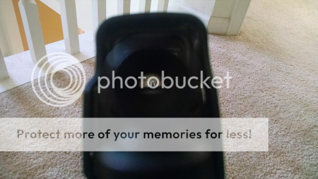

    I am just curious if irons sights always sit this low in an Eotech. at the "2" on my KAC 600m rear BUIS the bottom portion of my Eotech cuts the little circle in half. And it almost become level with the front sight. I tried to take a photo but I can not get my phone at the same angle as my eyes.If this is normal let me know. I tried to find a photo on google where somebody had the same set-up but my google fu failed. All the photos I looked at sit higher then mine do.

    I zero the irons separately with the RDS unattached. When I put the RDS on, I get a rough zero by matching the dot to the iron sight picture, but then finalize it separately. Even the EOTech is not 100% parallax free, and you will have POI shift between the RDS normal sight picture and using the cowitness.

    I assume that's an EXPS series EOTech? If so, it has a 7mm riser built in so it has a lower third co-witness. So what you see is normal. If you're after a more "centered" co-witness, you'd need the XPS EOTech.

    You're not really meant to use the irons in conjunction with an EOtech. It will be, at a minimum, a lower 1/3 cowitness. Sometimes it will be a lower 1/4. You are only supposed to drop down to use the irons if you really need them.

    I understand this. my main question was how i was suppose to co-witness it (for my rough zero before final zero) if i cant even see my front iron sight. but you guys answered everything.
