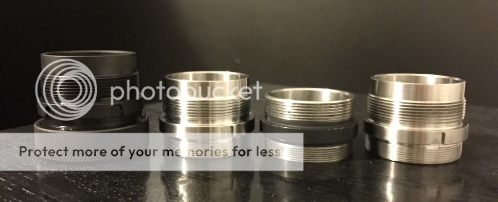

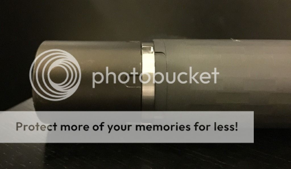

    Update for anybody interested. Made an adjustment to the adapter based on the newer ASR mount design. SiCo had gotten a lot of reports of cans getting stuck on rifles, mounts getting stuck inside cans, and general carbon buildup. They've since redesigned the ASR mount to add an extended smooth lip that seems to have at least reduced, if not eliminated, the problem.
    Got the new version today and tested it on an Omega and also with my Y-Mount MAAD mount. Everything seems to fit perfect. However, I don't have a standard Saker Trifecta MAAD mount, and I'm assume that will be the most common use. I'll be able to test fit that later this week and then we'll post the item up for sale on THSF's website. (Ti version is the only one currently planned to be produced). Some new pics:
    Omega ASR mount, new adapter (SS), current adapter from different source, new adapter (Ti):
    Ti adapter with Y-Mount MAAD:
    Ti adapter in Omega body:
    Everything together:
    Another view:
    For anybody interested:
    Old style SS adapter: 1.4oz
    New style SS adapter: 1.6oz
    New style Ti adapter: 1.0oz
