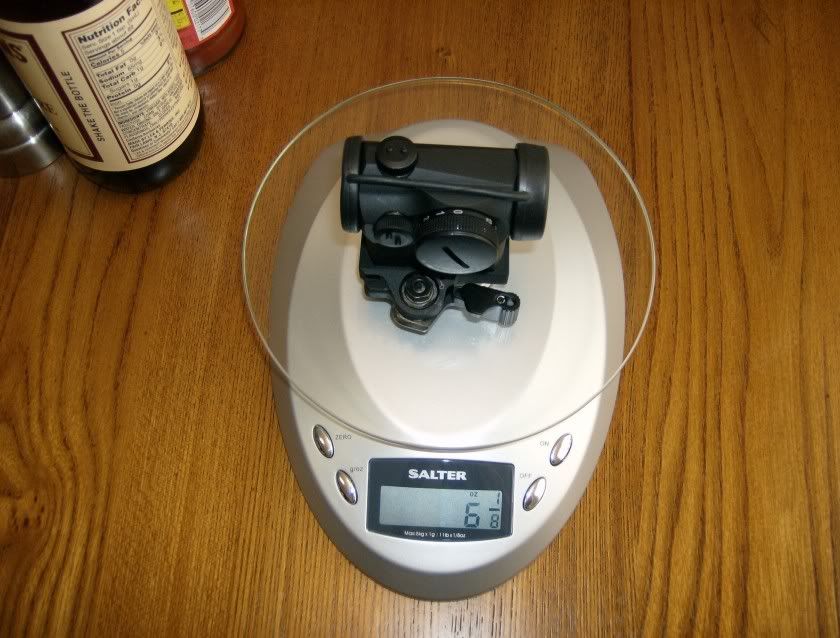

    Aimpoint T1 (w/rubber lens caps) + LaRue tall mount = 6oz
    ...this has me wondering, is there any utility in starting a consolidated weight thread for bits & pieces, as well as rifle configs?

    And MMcfpd is right, it's 6.1oz, not 6oz as I stated (went and reweighed mine).
