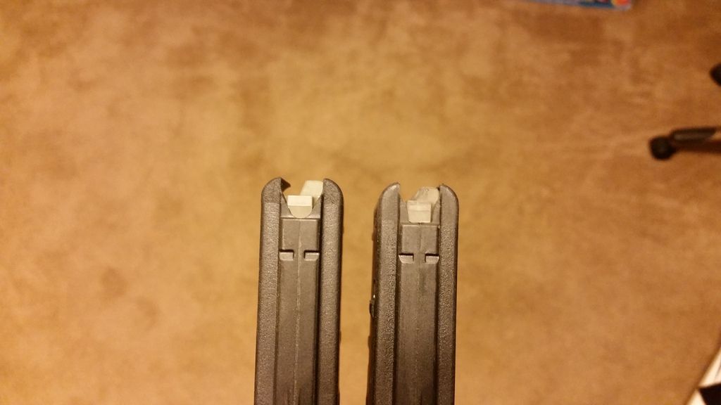

    I have a BCM upper and I've had problems with my bolt locking open after firing my last round. I think it has something to do with the pmag followers getting nicked somehow.
    This is how several of my followers have become recently. Anyone know what could be causing this?

    I have run into a few Pmags that would not hold open after the last round was fired.
    What I found was the top of the rear spine just below the "U" or "V" channel had some plastic flashing that when the magazine was in place would make contact with the bolt hold open and not allow the spring pressure to push up and lock back.
    Took a razor knife and trimmed the flashing so it did not make contact with the bolt hold open and all is well.
    Worth a look, just separate your halves and put a magazine in and toggle the hold open and see if there is contact.

    I've had this happen with a few Pmags as well. I took the mag apart and used a small square file and reshaped the opening from a rounded off "U" shape to a defined square shape and the problem was solved every time.
    Can you explain in a little more detail pls? Or even just a picture

    On gen 1 and 2 pmags the U shape on the top rear of the magazine body has a little flashing that can rub against the bolt catch. It will contact the wider portion, not the little tip that rests on the follower. This prevents the follower from reliably pressing the bolt catch upward after the last shot.
    Refer to the first picture in this post by Pandamonium: https://www.m4carbine.net/showthread...23#post1120823

    Original on the left, modified on the right.
