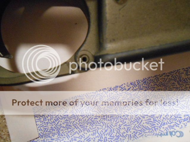

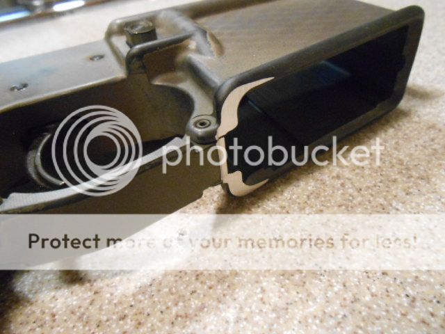

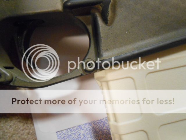

    Quote Originally Posted by P2000 View Post
    Here are some photos with yellow tape to show where the tab interfaces. The bottom pic shows that with loaded mag inserted, the tab should not be contacting the lower or trigger guard. If I were the OP, I would look to see if the tab is contacting the trigger guard, or the lower. Sometimes the trigger guard sits higher than the lower, so it would be contacting the tab. File the affected area (trigger guard or lower) until a gap is present with a loaded and seated mag.
    Great photos and clear instructions! That's just what I needed. Thank you.
