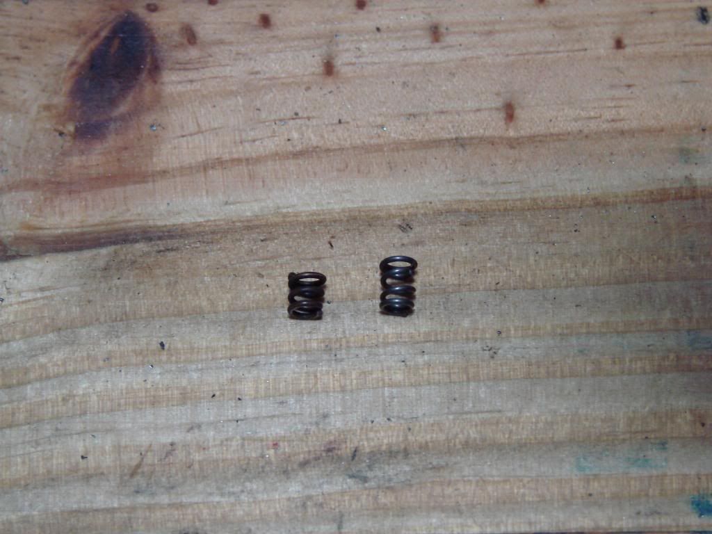

    Extractor Spring Comparison
    I tried some searching, and couldn't find what I was looking for exactly so this seemed as good of a thread to necropost as any.
    In a recent order I added a couple of BCM Extractor Spring Upgrade Kits. I figured they were cheap and they would probably come in handy at some point. I was recently cleaning my rifle and decided to compare the factory extractor spring with a new one from BCM. The upper started as a complete DD upper I got from SmartGunner a couple of years ago when they ran a special that caused all sorts of drama (you can read about that elsewhere). It's a 16" middy with a lightweight barrel. The bolt carrier is laser etched with the DD logo and there are no markings on the bolt itself but I'm given to understand this is common with DD bolts. I popped out the original extractor spring (which included a black insert, but no O-ring) and opened one from BCM and compared. The BCM spring is noticeably longer than the DD spring as you can see below. Is this a normal DD extractor spring? Should I go ahead and install the BCM spring? The only issue I've ever had with this rifle is that I get occasional malf's with steel cased ammo (Wolf). I've never had an issue with brass cased ammo (except when I tried out a McFarland gas ring). Based on previous reading done here I was going to install the new black insert, but not the O-ring that was included in the BCM kit.
    By the way this rifle has between 1400-1500 rounds through it. If the new spring would increase reliability with Wolf ammo that would be great, but that's not necessarily what I'm after.
    DD on the left, BCM on the right.
    Steve

    I only have one DD BCG, that came with my MK-18, and it has the shorter 4 coil spring like yours. It's an older version of the extractor spring, but it's been reliable so far with PMC and Wolf. Once I start having extraction issues, I'll drop in a 5 coil, and or, an extractor if required. The current wisdom, is to go with the BCM, or other quality 5 coil extractor spring for increased tension, with either the black insert or black O ring, but not both, for added reliability. I have a good supply of spare parts that include BCM and Spingco 5 coil springs. I'd run with the 4 coil until having extraction issues, then drop in a 5 coil, or simply drop in the 5 coil for peace of mind...it's cheap insurance.

    Thanks for the response. I noted a typo in my post above and have corrected it. This is what it now ways.
    I didn't mean to say that I would NOT install the black insert.
    I'll go ahead and put the BCM spring and new black insert in the gun. This has me anxious to try shooting some more Wolf ammo (which I happen to have) and see if reliability is improved with it.
    On a side note you mentioned this is an older version of the spring. Do newer DD rifles come with the longer 5 coil spring now?

    This spring business can turn into a bag of snakes. My solution?
    -Mil-spec buffer spring for carbine/rifle (whatever you have).
    -Mil-spec ejector spring
    -CURRENT Mil-spec extractor spring with NO O-ring. This works on everything from the MK18 to the A4, and it eliminates all the guesswork. Colt did the R&D for you as part of a PiP. Just order it, it takes a few weeks, and they allocate it to you and it ships. I haven't seen it come "in stock", but I have received orders of them.

    I didn't realize there was another spring floating around out there. Thanks for the link. As it is for now, I'll run the BCM spring and see what happens. As noted this rifle wasn't problematic (with quality ammo). I was just a little surprised when I saw the spring that came out of it vs. the spring from BCM.
    I didn't think about it earlier but I probably should have noted in my original post above that the rifle has an A5 RE with Sprinco green spring and standard A5 buffer. I guess you'd call the buffer the A5H2.

    I run in everything from unsuppressed 16" middy to a suppressed 10.5" and it works great. Boringly consistent. Colt designed it to eliminate the need for the O-ring, while correcting all of the geometry flaws of the "5-coil" and other poorly designed springs out there. They compress far beyond what is healthy for a spring, the Colt spring does so only marginally. It's a very small spring, and wire-thickness and geometry play a big role. I remember when RSilvers was modeling all of the springs using software, this one far and away was better than any of the others, except the original M16 spring, which had much less tension than this one. However, it is designed to compliment the mil-spec ejector spring, and won't over-power it.
