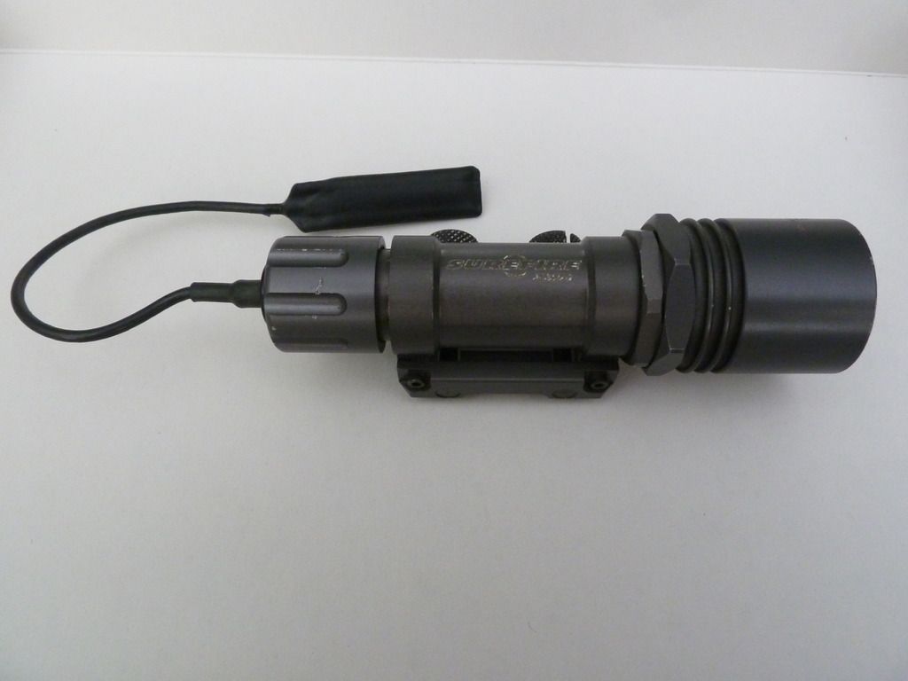

    So I bought this light a while back from a buddy that worked at a pawnshop and the pressure switch was/is toast.
    After much reading I ordered a Solarforce L2 s6 tailcap from Ebay.

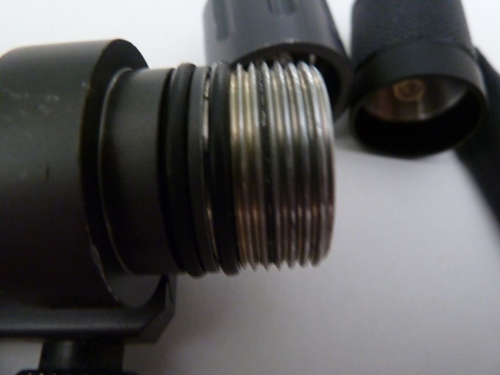

    It arrived today and the test fit is no go.
    After playing with it, it will screw on about 2 full turns and that's it.
    Is the light a Fake ? or my threads jipped up? on light or new tail cap ?

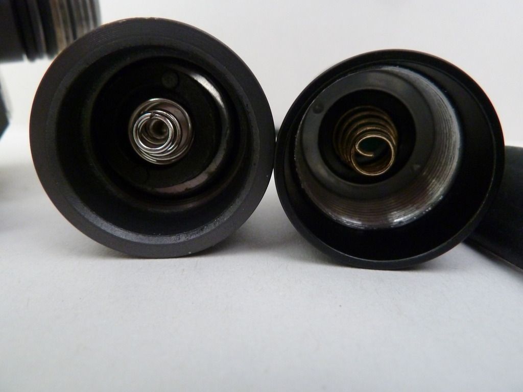

    You can see the first couple threads are more rounded, I think that's for me trying it back and forth.
    Surefire Left, Solarforce Right

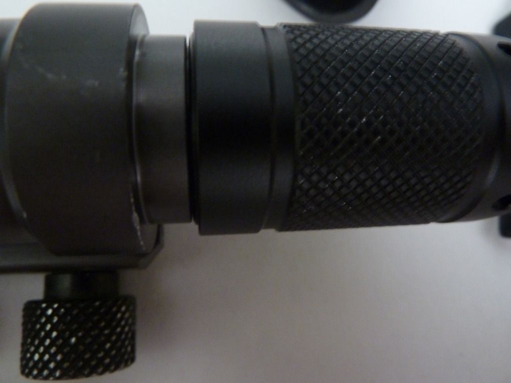

    The only thing strange looking is the cruddy engraving. It almost appears as if someone painted the light body and then stripped the paint leaving behind the remnants in the laser engraving that wouldn't wipe clean given the porosity that results from the engraving.
    Just a thought.
    To my knowledge, no one makes a knockoff M-series body. They are difficult to machine. Most likely the tailcap is the issue.

    After much aggravation and not really wanting to put any more money in the light, I went to twisting.
    After much turning and cutting we have a working light.
    The only things I can figure is the light had trapezoidal threads and the cap has square cut ???
    And/or the brass colored anodizing was to thick?
    The original cap still fits with no play.
    Either way its working now and its heavy as lead!
    I guess its low tech recoil mitigation.
    But for 30 bucks, 20 for the light and 10 for the cap, I'm happy.
