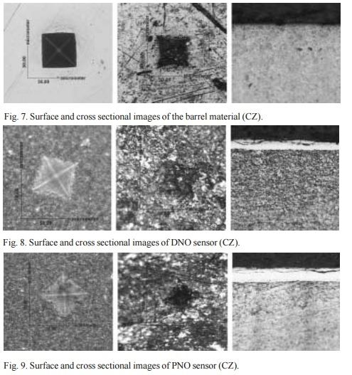

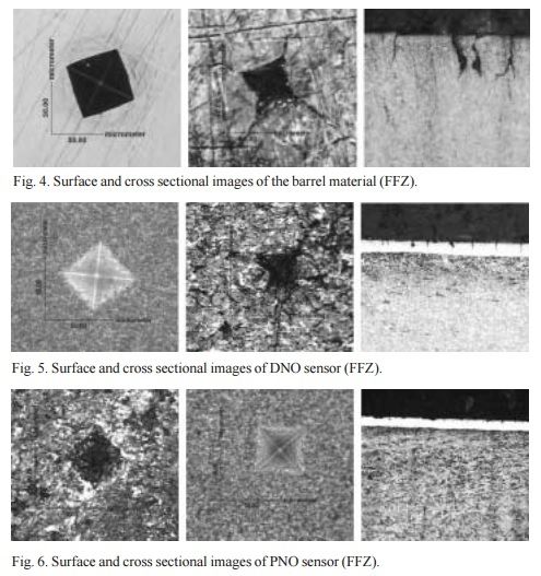

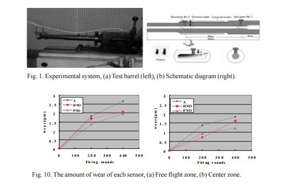

    After browsing international databases, I also came across research from South Korean Department of Weapons Engineering, that evaluated erosion of plasma nitrided 5.56 barrels, in dense and porous gaseous techniques, with M193 projectiles.
    http://www.ciar.org/ttk/mbt/papers/symp_19/LD14_323.pdf
    A STUDY ON THE EROSION CHARACTERISTICS OF THE MICROPULSED PLASMA NITRIDED BARREL OF A RIFLE
    Dong-Yoon Chung, Hee Jai Kim, H. N. Kim
    Department of Weapons Engineering, Korea Military Academy, Seoul, South Korea
    19th International Symposium of Ballistics, 7–11 May 2001, Interlaken, Switzerland
    Here's an excerp from the end of that document:
    4. CONCLUSIONS
    The surface of wear sensor was put under nitriding and postoxidation treatment after controlling the compound layer densely or porously using the micropulsed plasma nitriding technology. The sensor was inserted into the free flight zone and the center zone. The
    erosion characteristics by the propellant gas were measured and the following conclusions were obtained.
    1) In the free flight zone, oxidation after porous nitriding treatment shows the best antierosion characteristics and the preservation status of the compound layer.
    2) In the center zone of the barrel, there are no big differences in the anti-erosion characteristics for the different surface treatments. However, there is peeling of the oxide layer by tangential cracks under the surface resulting from shear stress.
    3) Comparing the environment between the free flight zone and the center zone of the barrel, the pressure from the propellant gas is the dominant factor in determining the erosion characteristics.
    4) Regardless of the surface treatment, the wear increases linearly as a function of the rounds fired.
    5) The peeling of the oxide layer which occurs in the center zone of the barrel, needs to be studied further for validating the micropulsed plasma nitriding technology.
    What I'm unsure about is whether the first test article, "A", used as a base line comparison was a barrel in the white, or chrome lined. It wasn't explicitly stated, the only description was the "barrel material used in the present". I assume that it must therefore be CMV at the nominal, but unknown if it was plated, based on the pictures, that don't show a clear delineated chrome lining from the cross sectional views, I assume it was in the white.
    Below are some pertinent figures from the report, A - baseline (again unknown if chromelined or in the white, strongly leaning in the white), DNO is the designation for densely nitrided/oxidation, and PNO for porous nitride/oxidation. The research was only conducted on those three test articles, barrels, with a "sensor" section, essentially a coupon cut out near the chamber at the free bore end (labeled FFZ - free float zone), and at the center of the barrel, designed CZ - center zone, in the report. Unsurprisingly, the erosion and crack formation is highest near the chamber. However, interestingly, no noteworthy cracks were observed at the center, unknown barrel length, for the baseline barrel, but both nitrided barrels showed tangential cracks on the surface. Based on this preliminary set of data, it would seem that the porous plasma based nitriding techniques is superior than the dense processing techniques with gaseous nitriding, but unsure how that translates to other methods currently employed like salt-bath.
    It's the most relevant research I've found so far to small arms evaluation of chrome v. nitride, as most if not all seems to be focused on large calibers. I wished the author would have explicitly stated if the baseline barrel was in the white or chromelined, would have evaluated alternative nitriding techniques like salt bath, and would have sent more rounds down range, up to the end of barrel life to the TDP nominal precision/MOA requirement for performance.
