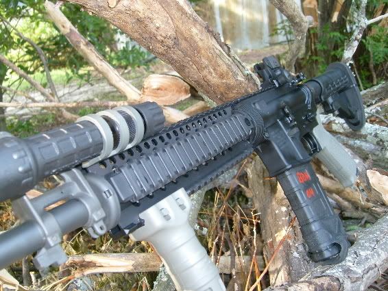

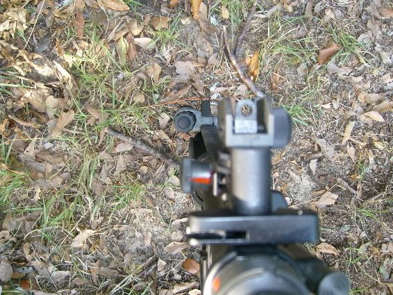

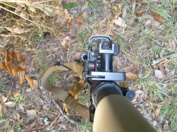

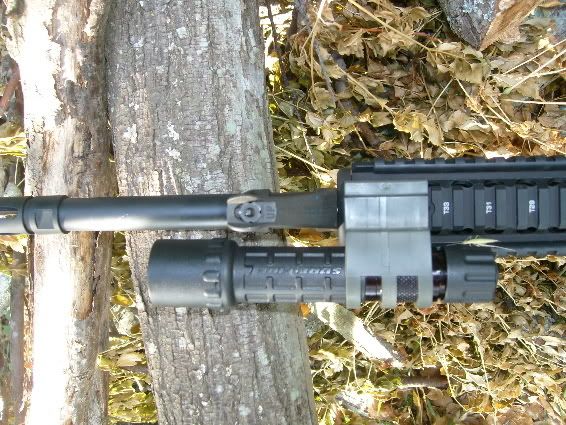

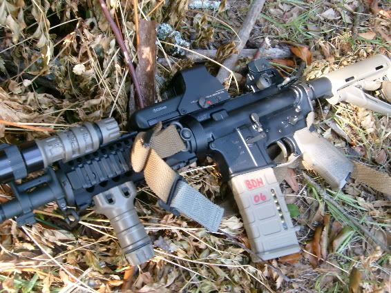

    Sorry about the small pics.
    I snapped em quick and sized them to upload quick. I thought they'd give you a pretty good idea though....
    I love DD stuff and their off-set mount should get you about the same spot, but further out from the rail. The VLTOR and VTAC tuck the light in closer which I prefer for several reasons... Closer to the bore, I find it easier for thumb activation, and I feel it is less subject to impacts and less obscured by obstacles because it is tight in against the rail.
    I ran the 16" rifle with the VTAC mount and no VFG for a couple of weeks, and it worked fine. My preference though is for the VFG, and I am trying to keep the two rifles the same in all but barrel length and optics.
    -RD62

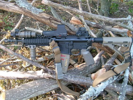

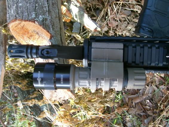

    New Pics !
    New Pics
    To answer you sling swivel question...
    I have no idea. The swivel was long ago removed from the middy and I use the sling mounts on the rear of the Omega rails for my slings anyway. I have no use for the standard front sling swivel. A Colt style side mount FSB swivel would work fine, but I prefer to run mine to the rear of the handguard.
