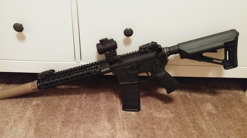

    I hit the range with my freshly built 11.5" Faxon Mid, and SLR gas block. I was using wolf steel and had to run it on setting 7 to get it to lock the bolt back while un-suppressed(I left it at 7 while shooting suppressed as well) I'm running a standard Nib toolcraft bcg and h2 buffer with a stock spring for now. Though i'm building another SBR lower for this setup that will use a A5H4 setup.
    I brought my BCM carbine 11.5" along and shot them both with the same lower and the Faxon middy was definitely was softer shooting, though I'm sure that's all the adjustable gas block. I'll have to open the gas block up to get a decent comparison, of the mid 11.5" vs. the carbine 11.5".
  3. #73
    FaxonNathan Guest
    That is one FINE looking weapon system.
