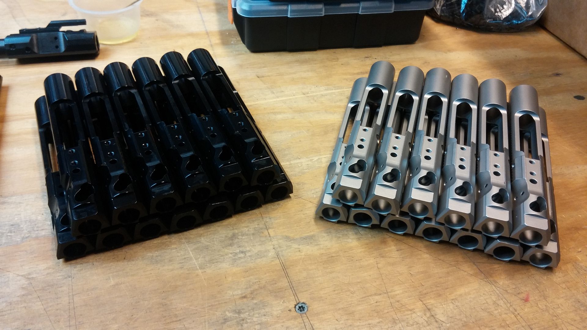

    I like to keep a bunch of all varieties in my stash.
    Here are some nitride and NiB ones.
  7. #27
