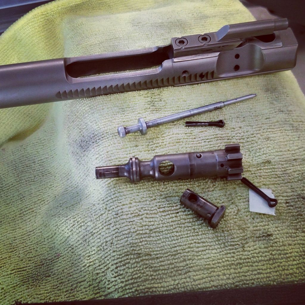

    This one had just over 5K on it when I pulled it apart to clean it. It was in the demo carbine we built for the Atlanta PD Firearms Training Unit for evaluation. They were not doing any periodic cleaning or light lube as we recommended. It took me less than 5 minutes with a tooth brush and rag to get it very clean. I don't have more detailed pics as I took this during the course I was teaching.
    Quote Originally Posted by WS6 View Post
    I would like, if one can be posted, a photo of a cam-pin, and a bolt, done in NP3, that has seen 5K+ rounds of use suppressed. I want to see how the coating holds up. I know Chrome fails fast on cam-pins, so I am curious about NP3.

    Looks like it wears well! When it does wear through, does it flake or peel?

    I don't know because we haven't see it yet. I think ROBAR has been doing NP3 for over 20 years or so. One would think that any major issues would have revealed themselves at this point.
    That pic was taken in April or May when I taught the class with APD SWAT and FTU. That rifle is still in use and has probably 8K or so on it.
    I've got an 11.5" upper in the shop with about 13k on it, ran suppressed 80% of the time on a full auto lower. I will snap some pics Monday or Tuesday.
