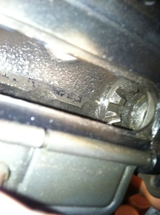

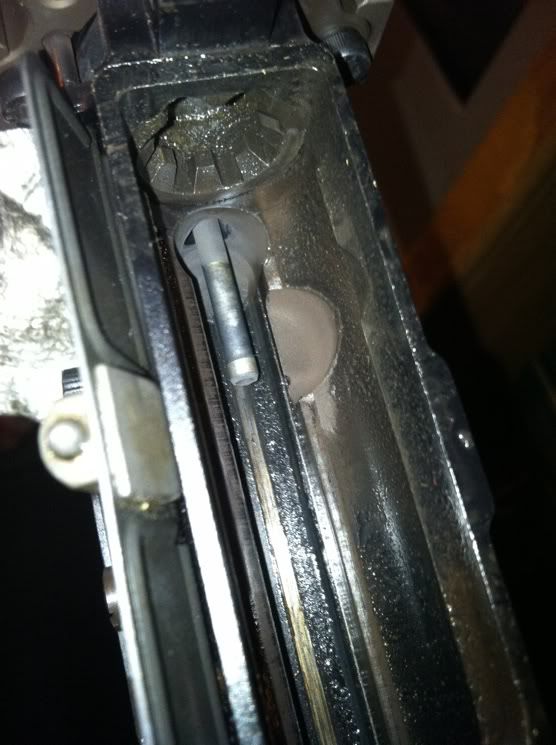

    To the OP. This is my old Mk18(lord rest his soul) after a shooting session of 800 rounds of 55gr Wolf steel cased ammunition. I only lubed it before the range session and not again. Also not wolf runs much dirtier than standard quality brass.
    http://i203.photobucket.com/albums/a...s/IMG_1665.jpg
    http://i203.photobucket.com/albums/a...s/IMG_1037.jpg
    http://i203.photobucket.com/albums/a...s/IMG_7533.jpg
    The only stoppages I had were due to the incredibly overgassed nature of the DD MK18 barrels of the time(.086 when it is supposed to be .071) which were 3 failure to extracts where the case rim was ripped off, which was solely due to the timing being out of line because of the gas port.
