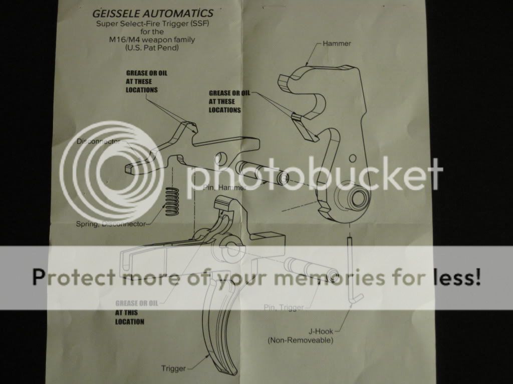

    Thanks! Are the instructions good about what points to lube with grease/oil?

    Quote Originally Posted by Kyjames View Post
    There is an included diagram with the trigger that clearly show the lube points. If you picked it up used and do not have paper work you can download it from the Geissele web site.
    Here
