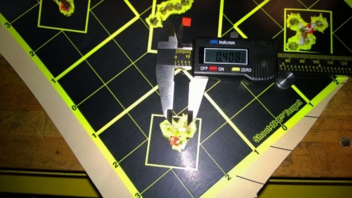

    I very impressed with the Hunter 700. The ability to customize the ergonomics to suit a persons individuals requirements is awesome. Especially at this price point. I just got a set of risers today and raised the comb with the .50 inch along with adding an additional spacer to lengthen the LOP to 14 inches. Now the fit is even better. I'm looking forward to bettering my first outing with it this weekend. This is new AAC-SD handload 168 HPBT backed with RL15 powder using Lapua brass, a little over .4 MOA 5 shots at 100 yards. Magpul CS is superb. I've called them a few times with minor issues and questions and they have always been nothing but friendly and helpful. I've only one minor complaint with Hunter 700 which I noticed first time I set it up. The screw that locks down the LOP spacers/comb allen head bore stripped first time I tried to remove it. I can use a flat blade but would like to get a replacement. I would like to avoid having to carry a large blade screwdriver in my kit. OH, second minor complaint.... that the 10 round mags are not here yet!
