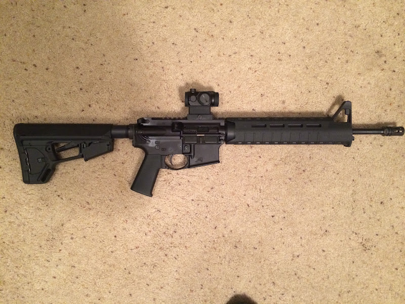

    This won't live up to the Molon level standards that we all so enjoy but I figured I'd post my findings. Recently built this gun for my mother who has taken more of an interest in shooting over the past year and decided she wanted a rifle.
    Specs are as follows:
    Aero Precision upper and lower
    ALG Defense QMS trigger & LPK
    BCM RE/spring/H buffer/charging handle
    Magpul K grip, ACS-L stock & SL handguards
    Toolcraft BCG
    Ballistic Advantage 14.7" pencil Mid-gas 5.56 barrel w/FSB (1/7 twist)
    A2 flash hider
    First impressions after the first couple of outings: very lightweight (theme of this build since it is for a little old lady), very soft shooting. The gas port must be on the lower end of the spec, it is definitely softer shooting than my other middy 14.5" and BCM 16". They don't bother me but she thought the recoil was a little harsh on those two, she likes hers quite a bit however. I had no issues with wolf gold 223, m855 or any of the ammo I shot today. On my second outing with the gun we did have a 2-3 instances where the bolt failed to lock to the rear on an empty magazine when using PMC bronze 223, but it never failed to load the next round if there was one in the magazine. After those failures I added some lube to the BCG and loaded a single round of PMC bronze into ten mags. All ten resulted in the bolt locking back after firing so hopefully it is just a break in issue. I will be keeping an eye on that though.
    So onto the slightly more interesting stuff. Today was our 3rd time out with this gun and my goal was to see how accurate it could be with decent ammo and a scope. I am planning on building a 20" A4ish type rifle here pretty soon and am waffling between a BA QPQ or a Green Mountain chrome lined for that build. This test was part of my plan to help solidify that decision. I'm relatively happy with the results from this barrel considering the pencil profile, non free-float handguards and my impatience (not letting the barrel really cool down much between strings).
    Here is the rifle as it normally sits:
    And here it is in the configuration that I used to do my accuracy testing:

    Wish they made that barrel in carbine length. It would be perfect for a retro build I'm looking to do. Any idea what your rifle weighs?

    I haven't weighed it. Going by weight of another build and adding/subtracting differences in part weights, I'd say this one is 6lbs 10oz. I will be putting on a lighter stock at some point though. I'll try to remember to take it to the shop next week and put it on the scale.
