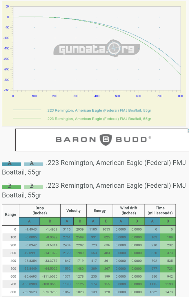

    If only they had a reticle option with the illuminated segmented circle and non illuminated Mil-box crosshair instead of the predetermined ACOG type BDC. That would be just about everything I want in a 1-4 reticle. Bold segmented circle for quick acquisition up close with a usable mil reticle for longer range.
    I like that segmented circle reticle so much that I'm trying to figure out how useful the BDC reticle would be for a 12.5 inch barrel. The chrono data I've found on 12.5 Noveske Crusader barrels and M193 put it at about 2940 FPS vs the M193 at 3116 FPS Trijicon used for the BDC.
    Doing some rough calculations online it looks like it would be fairly useful with the 12.5 Crusader barrel and 55/62 grain ammo using a 100 yard zero out to 500-600 yards on a torso sized target. That's asking a lot of a 12.5 barrel and 1-4 optic so at more reasonable ranges of 3-400 yards it doesn't look too far off at all.
    Bullet A is as close as I could get to what the BDC is calibrated for and is used as a baseline in both charts. Bullet B is a comparison of 55 and 62 grain ammo with the lower velocities of the 12.5 inch barrel against the baseline ammo. Chrono info for the Noveske 12.5 Crusader was found in posts made by MSTN on TOS.
    55 Grain comparison
    Bullet A: 55 grain at 3116 FPS
    Bullet B: 55 grain at 2940 FPS (12.5)
    62 Grain comparison
    Bullet B: 62 grain at 2836 FPS (12.5)
