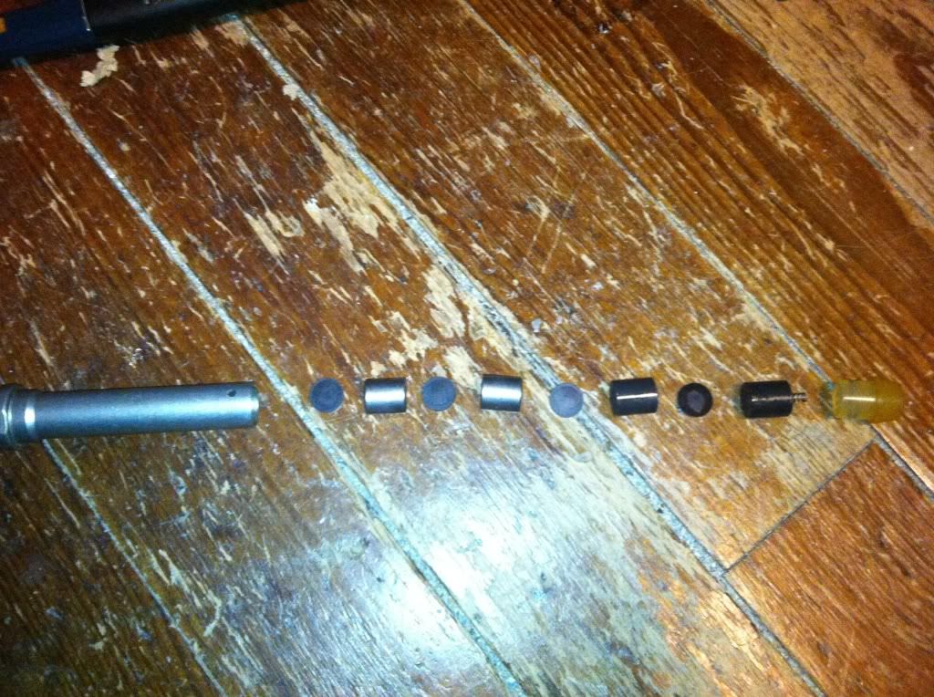

    The other difference in the A5 system is the use of a spring internal to the buffer. They say it helps keep the weights forward for more consistency during the initial movement of the buffer aft, and then helps bolt bounce at the other end of the cycle.
    From the M4C Vltor A5 thread, SinlesSorrow's pic:
    But yes, the A5 has been discussed for years on here with lots of good info available. I have not jumped on the Sprinco Green bandwagon yet, the standard milspec rifle spring works fine. That said, its only $20 so I am sure I will try the Sprinco down the road.
