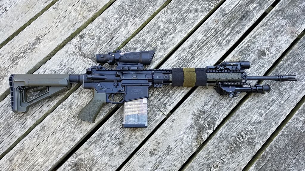

    OK so here's an update:
    I got a new gas block from Midwest industries (also tried hand fitting one from CMMG, felt no looser or tighter) and new gas tube from S&W. Reassembled the rifle, and made sure to have that .030" gap between the block and shoulder. Just shot 32 rounds and while they all fed and fired, the rifle would not lock back on the last round with two types of ammo.
    There is only a VERY slight bit of gas on the gas tube, which from what I read is actually normal anyway.
    So the question is... What the hell is going on? This rifle is seemingly not getting enough gas and I can't explain it.
    The carrier gas key looks and feels tight. Staking is good. I'll keep looking at the bolt and carrier to try and find something wrong.
    One more thing... Has it been verified that the A5 length receiver extension is the same length as the standard M&P10 tube? Just want to be sure, as mine wears an A5 tube. Buffer and spring are stock. The rifle locks back fine manually with room to spare, feels totally normal.
    Here she is... If only she would work!
