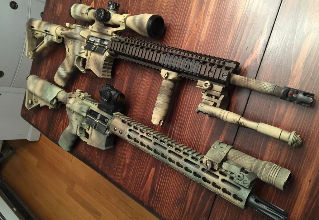

    Nice pic on the cerakote, I've got mine stripped to drop off tomorrow doing something similar.

    And its just a homemade rattle can job, but thanks !
