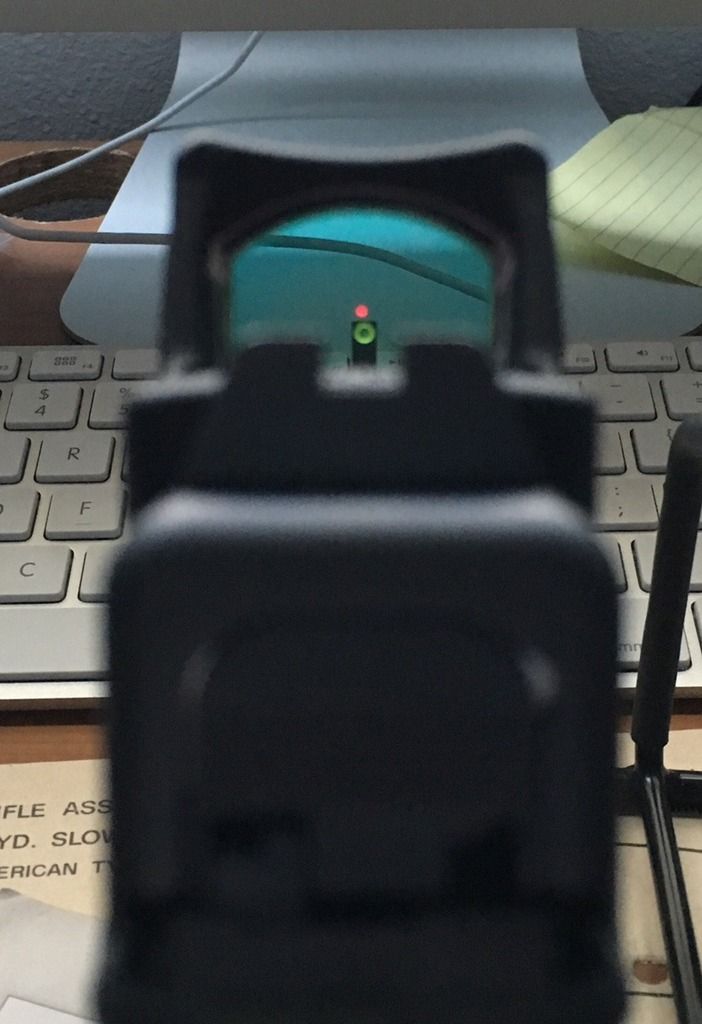

    I used an Ameriglo Front / rear. .315 tall, lumi green.

    Ordered the Dawson tritium front in .315 x .125 matched with the 10-8 .395 x .156 rear and the RMR RM06 + sealing plate.
