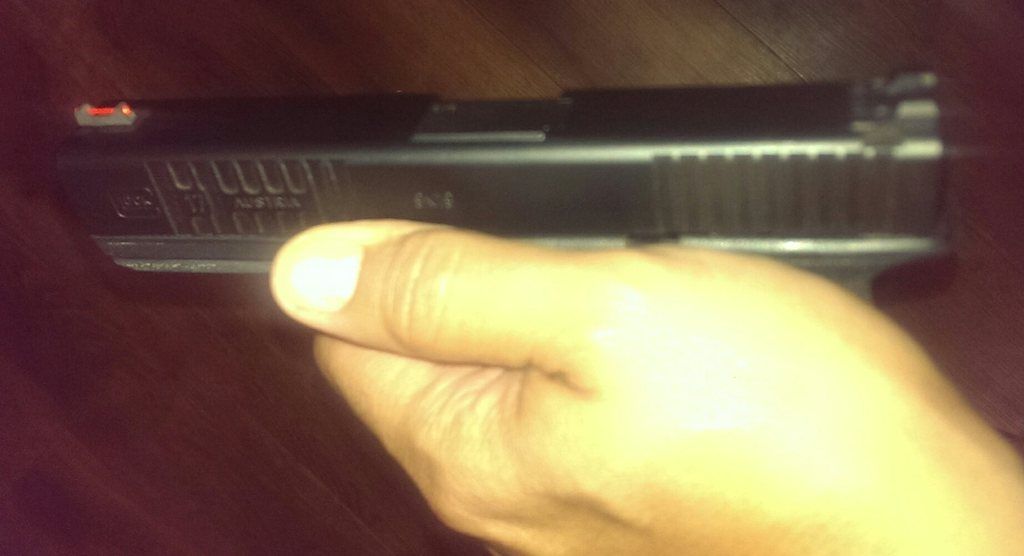

    My issued Gen 3 G19 fits my hand like a glove. Recoil control feels much better than the G17. with my own accelerator cuts, it felt good but needed texture for more bite.
    I will test further before I attempt any material removal.

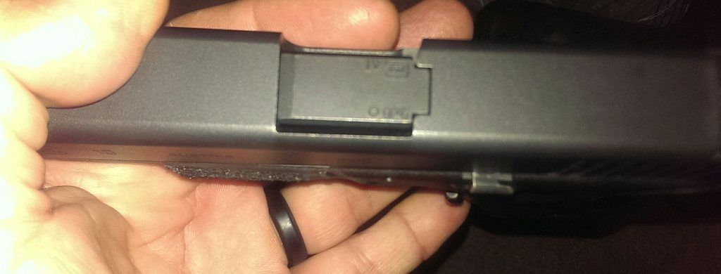

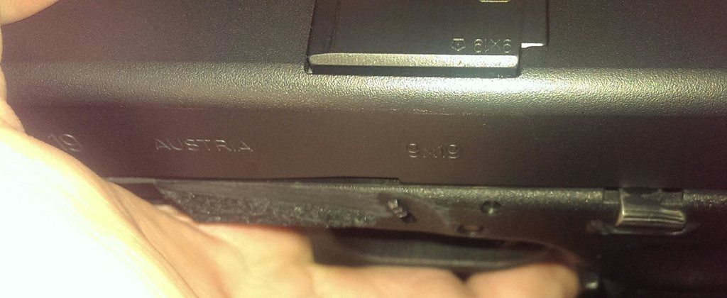

    I got my G19 back today......its not a "Maiden" Job but function over form.
    it feels good. Hope to test soon
