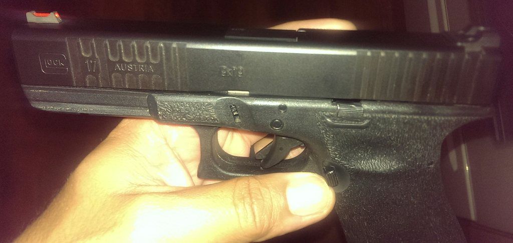

    I have seen most of them and the best work I think is done by ATEi. Most good shops will mill it to your exact RMR dimensions so when you have to take it off the return to zero is easy.
    Personally I would not use Suarez as they dont mill the posts for the RMR. Again most good shops will mill the two RMR mount posts into the slide. This helps with on/off return to zero but also doubles the strength of the mount as you are using the posts along with the screws to hold the RMR in place. Just like if you were mounting it to a RMR mount from Larue or ADM. This to me, is a must have and one reason why I dont like the MOS GLOCKS.
    Not my pic, but theses are the posts I am talking about:
