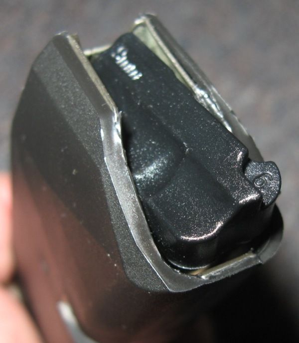

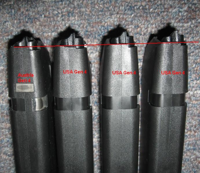

    On a number of the mags I bought, I have noticed some excessive follower tilt. I picked out the three worst to document here, but there's 4 others that are also suspicious....
    Ok, so that's not so bad you say...
    Well, the picture's don't really do it justice- the followers are about 2 millimeters from popping out of the body of the magazine. I haven't seen follower tilt/protrusion or sloppy fit this bad since some Korean mags I wisely decided never to buy years back.
    "But if it doesn't pop out it's not a problem"
    Watch this...
    There's one mag in particular that I can pop the follower out of the body with the slightest push on the side (where it's stamped #6) of the follower. And I do mean the *slightest* push- just a little pressure on the follower, really.
    I figured this out as I was looking at the odd follower positioning / loose fit on some of new mags VS the Austrian ones I have, and I said, "gee that sure looks like it's about to pop out" *click* "dammit, I hate being right".
    Well that can't be good...

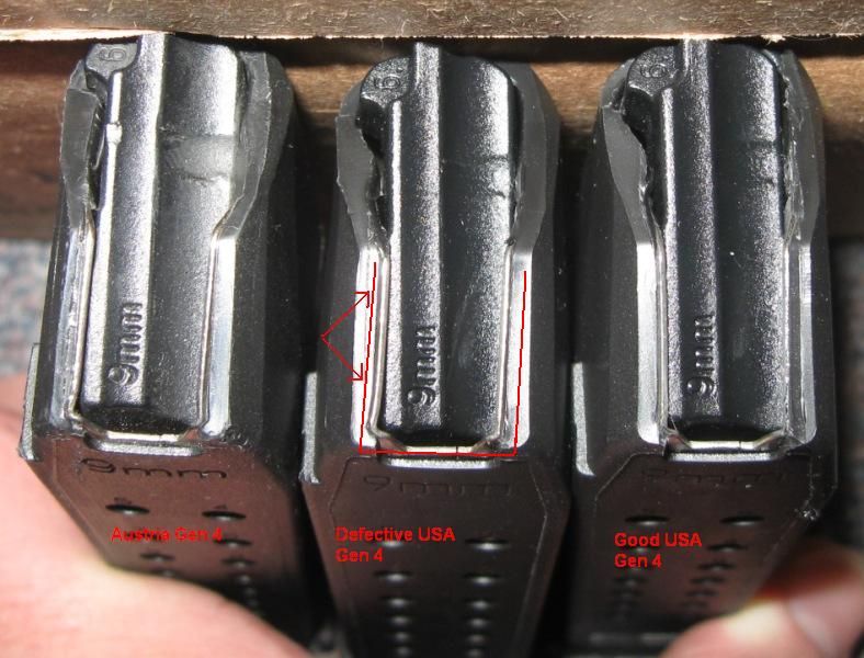

    The new USA made mags, out of 20, 2 have the followers catching on something in the mag body (seems like the little plastic internal tabs holding the metal shell in at the top), 3 are in the "WTF is this shit" category of the pictures above (1 follower pops out easily, 2 are a couple millimeters from doing so, I'm just not going to force them out), and 4 others I'd categorize as "suspicious" given what's going on with the first 5. Overall fit and finish is not as good across the board as the original Austrian mags (no surprise there I guess....), but the other 9 seem ok.
    I can't tell if my eyes are playing tricks on me or not, but it's almost like the feed lips on the ultra-defective follower-popping mag are twisted off, or something.
    In the first picture, it looks like I'm seeing an excessive bend in the internal metal body, but if you look at it next to the others, it almost seems like the whole feed lip area is twisted off (pic #2). Again, pictures don't quite show it right, but something's sure off...

    The springs haven't taken a set yet. Load them up and shoot them and the perceived issue should go away. If it doesn't, contact Glock and get them exchanged for new ones.

    The follower is popping out of the mag body. I was under the impression this is a problem with any magazine.

    You may want to break them down and inspect the springs. They may be the longer 11 coil springs that are meant for G22 mags. I run them in my G17 mags with the Glock +2 extensions.
