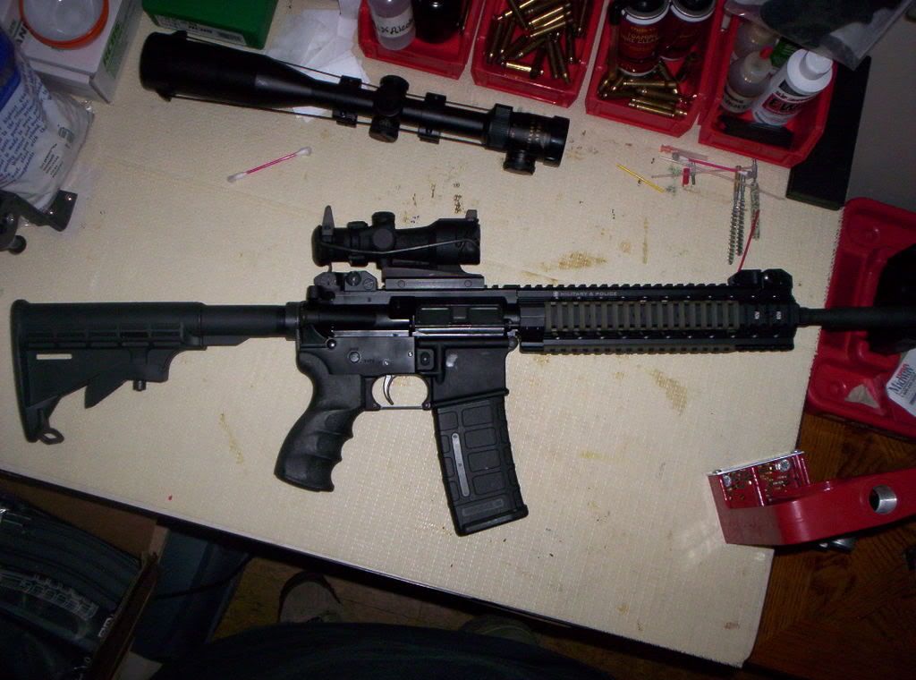

    Here's my rifle (old pic, I have since added a LaRue bipod adapter and Harris BRM.
    http://i261.photobucket.com/albums/i..._9-6-08005.jpg
