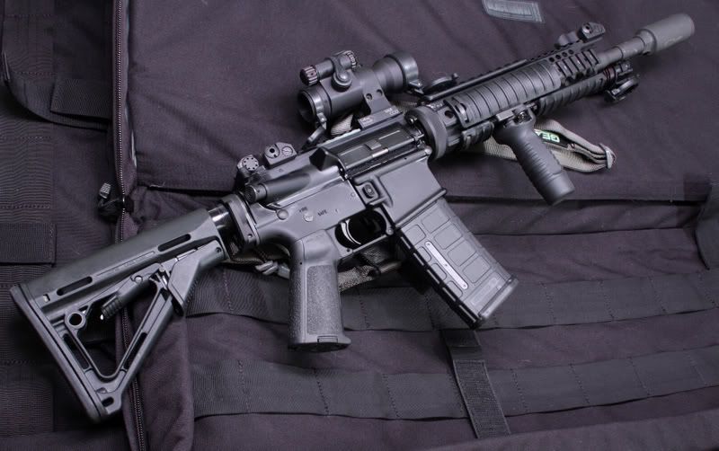

    cut the barrel down to 13.7, pin the KX3 on and it won't be that bad. after everyone leaves my office tonite, i'll try to weigh mine.
    and it shoots pretty soft. i'm running mine on a LMT, with the factory 16" LMT barrel cut down and an H2 Buffer.

    this gun is under 9# without magazine. and it's even got a 600 scout light with the mod1 kit on the other side. not that heavy at all
