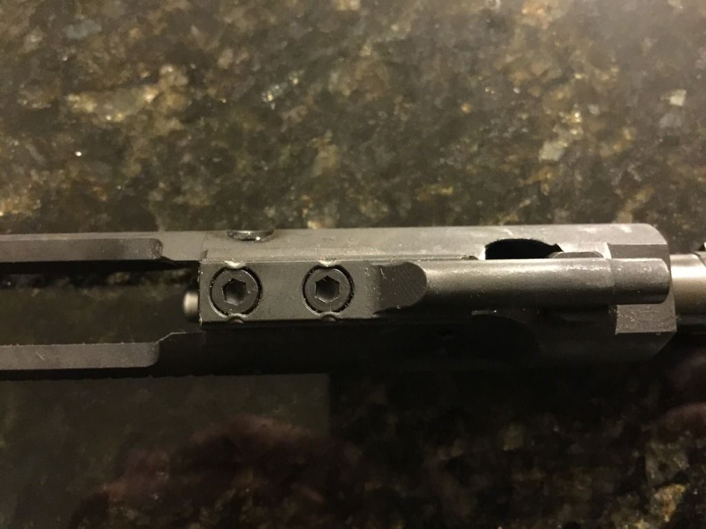

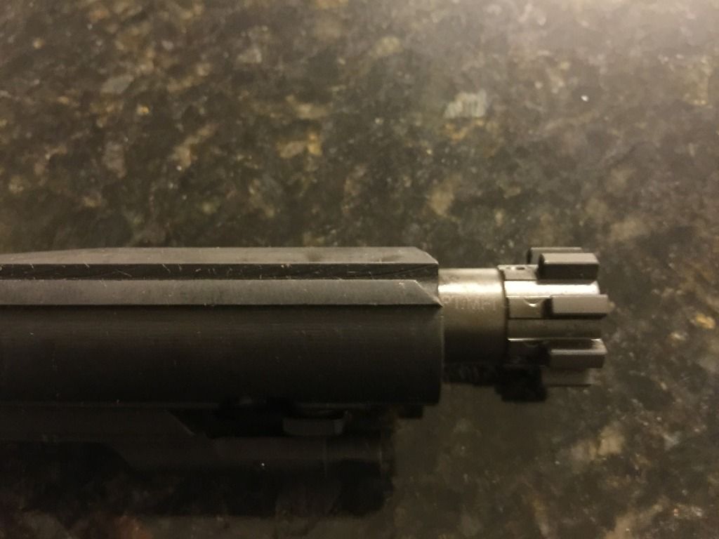

    Now, I do have a question about the initial cleaning. The BCG was described as being, "packaged dry" and having a "dusty appearance." They weren't lying, and you can make this out a little bit from the photos. Although, while true for the carrier, the bolt clearly had been lubed.

    Overall, I'm happy with the outcome. While I'm a bit puzzled how the first BCG made it out with that extractor issue, I feel the mfg went above and beyond by insisting it be replaced. I'll test it for function when the weather allows, and then toss it in the spares bin.
