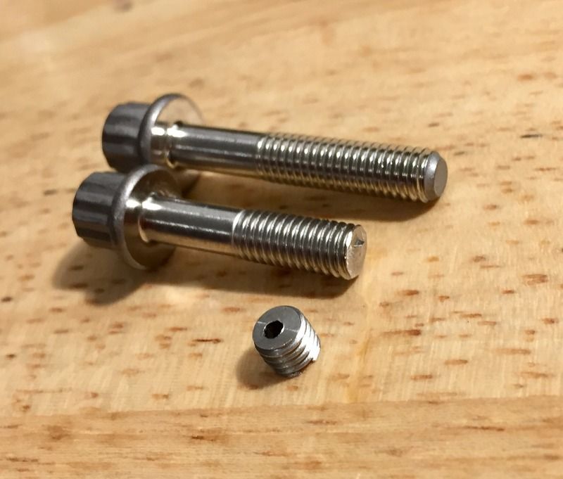

    Inconel 718 Update:
    Proof of concept
    Got a steal of a deal on the base 10-32 threaded 718 Inconel bolts, $15 for 25 I was worried they may have been falsely advertised until I started to cut on them (took 2 Dremel cut off wheels just to chop off the tip)! Each bolt can make about 3 inserts if you can afford crewing up carbide bits enough to make 75!
    http://m.ebay.com/itm/291918559723?_...-1&_mwBanner=1
    Process:
    Cut bolt
    Trim with carbide end mill
    Drill/rheam regulating hole
    Cut flat head slot
    This first one is kind of rough, I wish I had a better way to make the flat head slot. I got a carbide *100 countersink but coming to help index the drill bit. This concept insert was drilled with a cobalt steel bit very slowly (1 time use only), I also have carbide bits and rheamers coming to do this right. It is best to cut off the bolt to near the exact length desired for the insert because cut off wheels are much cheaper than the uncoated carbide end mill I dulled (won't cut Inconel anymore but still cut stainless) trimming to size.
  8. #28
    Nov 2010
    669
    18 (100%)
    Nice, well done. I wonder if I could do the screw slot any cleaner with a mill and a slitting saw? Might also make drilling the hole more on center easier as well? Unless, that was intentional?
  9. #29
    Jan 2013
    1,871
    25 (100%)
    Quote Originally Posted by elephantrider View Post
    Thanks. No the off center hole was not intentional, even if it doesn't really effect function it wasn't what I was going for. The cobalt drill bit walked when I first started the hole, which was expected since I didn't have any kind of indexing for it, just went straight in on the flat surface. After seeing how hard this stuff is to cut using the cut off wheel and carbide end-mill I was surprised how well the cobalt bit did, of coarse one time use only. The walking is why I ordered the carbide countersink bit to make a cone to start the drill bit and to provide a little bit of a beveled gas inlet.
    https://www.mcmaster.com/#2944a32/=16vemha
    The flat head slot has me thinking, o don't know how best to do it it looks like crap done by hand with the cut off whee (it also walked off center on me). What are you thinking with a mill?
