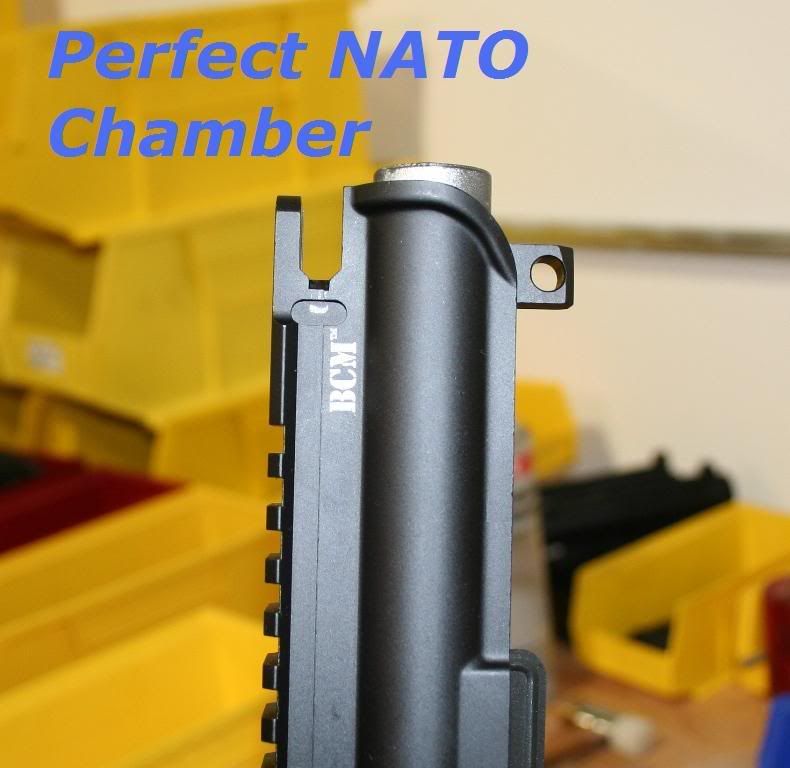

    Woofe,
    We looked at your upper group. It is PERRRRR-FECT!!
    It is NATO-rific!!
    Folks,
    Got a chance to look at this upper group and it is a perfect USGI NATO 5.56mm chamber. Please do not confuse that with a version of a SAMMI spec chamber that the commercial market likes to call NATO. They are very very different in dimensions. They are not the same.
    I could see these problems at the time of the first post. But anytime a customer is concerned about saftey, I want to always confirm everything is perfect with my own two eyes.
    Pictured above on a NATO NoGo. (Our headspace BCG’s have the back end of the carriers painted sliver so we can ID them.) As you can see, this upper is ready to go to WAR !!! grrr.
    I have taken at least a dozen emails and phone calls regarding this subject in the last week. (Damm, a lot of people read this board.) I just hope they read the entire thread.
    So this is the best advice I can give to the folks regarding this subject.
    1) Even if you think you're using a NATO gauge (because Brownells said it was or Clymer or Forester or ?), it is probably not the correct gauge. It does not matter what the label says. It does not matter what the label says. (written twice on purpose) Most are labeled wrong. Many labels are even arbitrary, because the gauge company or a barrel company decided what their "Go/No Go" gauges would be within their SAMMI or NATO chamber that they are building.
    2) Do NOT, Do NOT let your local gun store tell you anything about headspacing. (Virginia Arms is an exception, gotm4 gives some of the best advise on the net.) A full 99% of gun shops don’t know how to test properly, don’t know the difference between NATO and SAMMI, don’t know the proper gauge specs, they don’t know much. This also includes about 99.99% of the gun show carnival barkers.
    Let the gun shops sell you a pistol, let them give you a form #4473, let them mount your scope on your deer rifle, but do not - do not – do not let them touch your AR15. As an example, Woofe showed his upper to a variety of AR15 Vendors at the gun show (and other folks), and not one single one of them were able to see the errors in the method of measure. Please don’t rely on these folk for technical info.
    Of course Grant (who specializes in the mechanics of this platform) could see the error in the first post.
    3) A little knowledge is dangerous, but if you must mess around with a headspace gauges get a FIELD gauge. That is the only one you will need. That is the only one you will need. Not just any field gauge, get the NATO one that Colt recommends (.1.4736”)(Brownells #319-418-033). You are not building barrels, you are not fitting bolts. You are in “the field”, and that is your gauge.
    Double check the measurements on your gauge. I have seen many gauges with text and not marked with a numeric measurement and even mismarked dimentions. Get rid of them. Just keep the Colt FIELD Gauge
    Woofe – enjoy your upper group!
