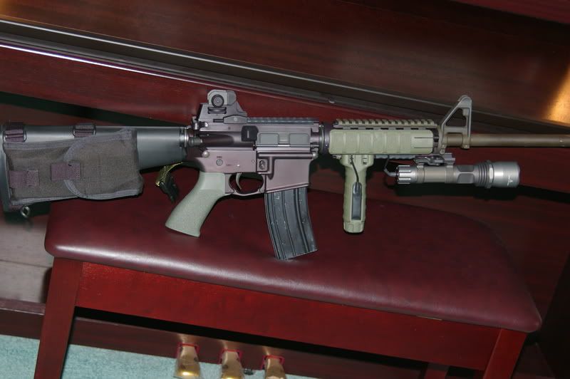

    The A3 model upper receivers have a built in picatinny rail that the carrying handle attaches to:
    That is a flat-top receiver without the carry handle mounted. As you can see, I have an iron sight mounted directly to the upper receiver. You don't need to manually install any rail space, as it's already machined into the top of the receiver.

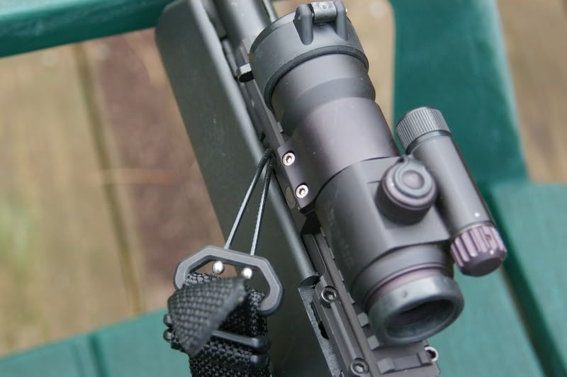

    To mount something like an Aimpoint to your upper receiver, you can use the mount that Aimpoint includes in the package with their optic and you can mount it directly to the top of the receiver. These are pictures of the mount that Aimpoint includes in the package. In the pictures I have the mount installed on an Ultimak rail for my VEPR-K, but it will mount the same way on the upper receiver of your AR:

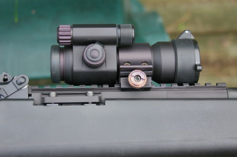

    The only downside to that approach is that the optic will sit too low to co-witness with iron sights. For that reason many will encourage you to invest in a good LaRue mount for your Aimpoint so you can use your iron sights as a backup to the optic. This is what a co-witness looks like, again using my AK:
