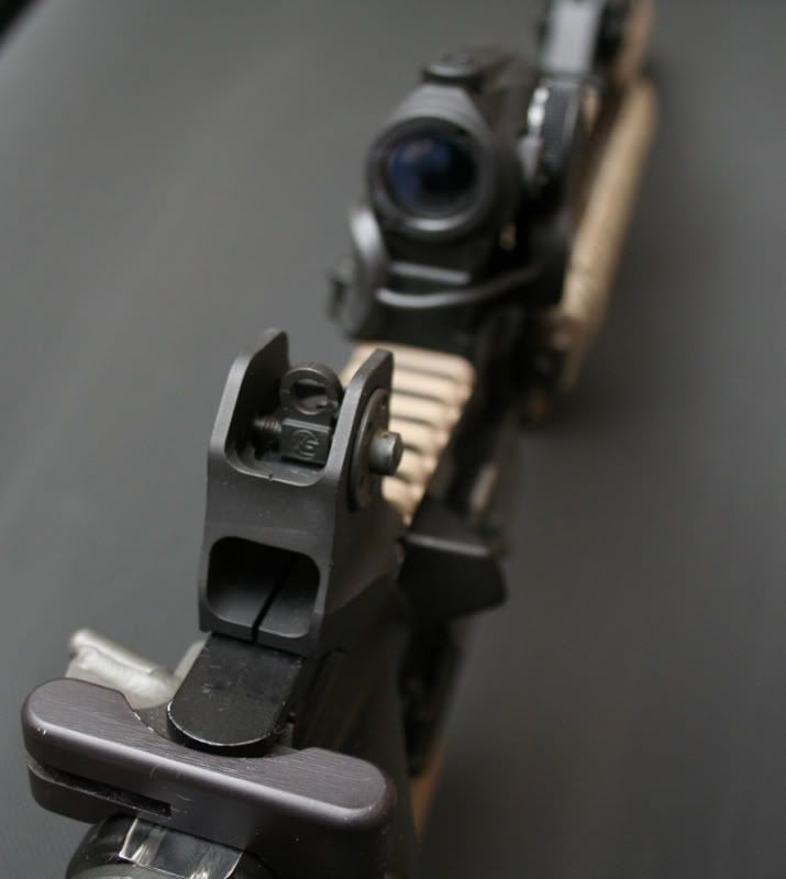

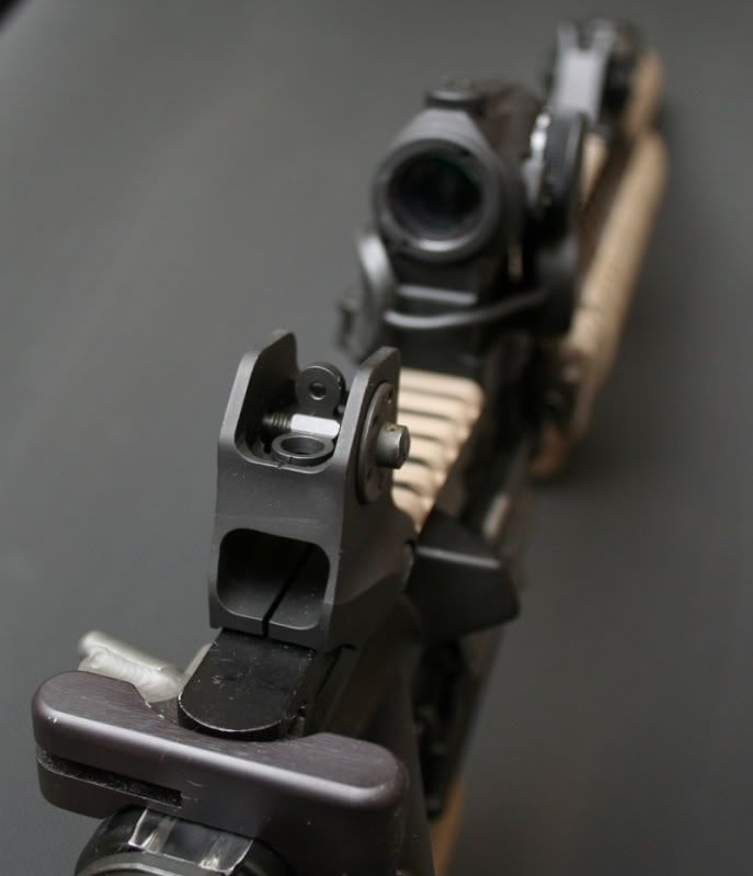

    It's actually easier to install it on a LaRue BUIS, well easier than a A1 or A2 rear sight. If you'll pay return shipping I'll install it into your LaRue free of charge.
    Here's my Daniel Defense BUIS and I installed a Ashley same plane aperture.
